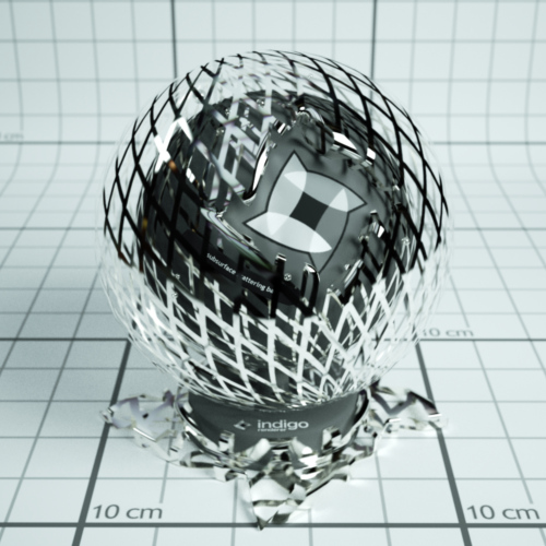

This on its own is not very helpful, however when combined with the blend material type it becomes very useful for making "cut-outs" such as leaf edges, which would otherwise highly complex geometry.

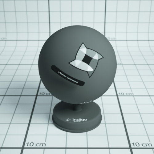

An example of the null material on its own.
An example of the null material blended with a Phong metal, using a grating texture as blend map.
