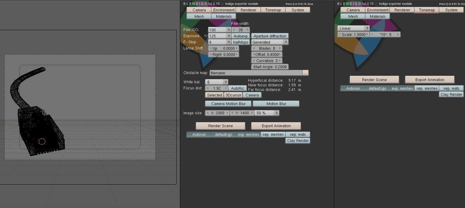

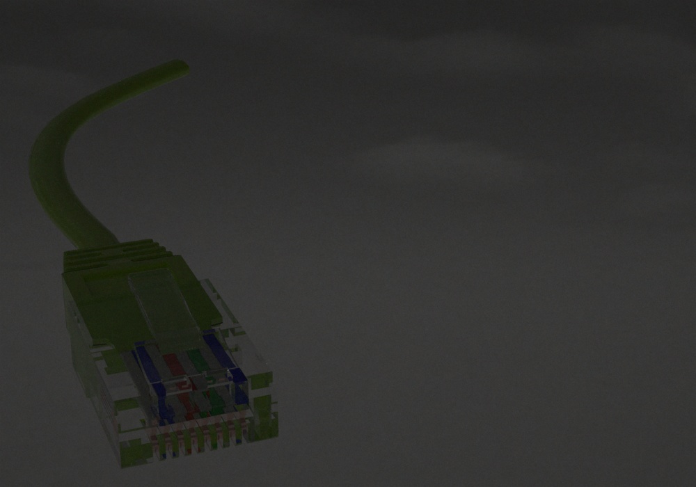

I've made lot of test and I don't understand why but F-stop and linear tonemapping give change tonemapping!? Is it right?
fstop 64.jpg (109.73 KiB) Viewed 4629 times
fstop 32.jpg (186.13 KiB) Viewed 4629 times
fstop 8.jpg (100.71 KiB) Viewed 4628 times
Capture 2.JPG (114.85 KiB) Viewed 4628 times
Capture 1.JPG (114.2 KiB) Viewed 4629 times

Post by fused » Mon Aug 10, 2009 11:56 pm
its correct. the lower the fstop the more light will reach the film :)

Post by Jambert » Tue Aug 11, 2009 12:22 am
fused wrote:its correct. the lower the fstop the more light will reach the film :)
Thanks :)
Re: F-stop and linear tonemapping
Post by PureSpider » Tue Aug 11, 2009 1:26 am
But it hasn't been like that in older releases of indigo. What about not changing random stuff without letting the user know, Ono? :roll:
Post by pixie » Tue Aug 11, 2009 1:38 am
PureSpider wrote:But it hasn't been like that in older releases of indigo. What about not changing random stuff without letting the user know, Ono? :roll:
If it wasn't as such before, it was wrong, therefore changing to right can only be the right thing to do ;)
Post by fused » Tue Aug 11, 2009 1:45 am
of course it was like that before. it has always been like that :)
Post by PureSpider » Tue Aug 11, 2009 1:59 am
Sooooo... Cindigo compensates the changed F-Stop? o.O
My pics never changed their brightness when I changed the F-Stop! :shock:
Josh
Posts: 44
Joined: Fri May 01, 2009 10:07 pm
Post by Josh » Tue Aug 11, 2009 2:04 am
Tonemapping (other than linear) masks the change of illumination, I suppose.
Edit: Camera tonemapping without auto exposure (and no manual exposure adjustment) should not compensate.
Post by fused » Tue Aug 11, 2009 2:05 am
probably because you used reinhard ;)
Post by PureSpider » Tue Aug 11, 2009 2:12 am
Just checked - and yes, I do use Reinhard in that scene I was talking about :oops:
