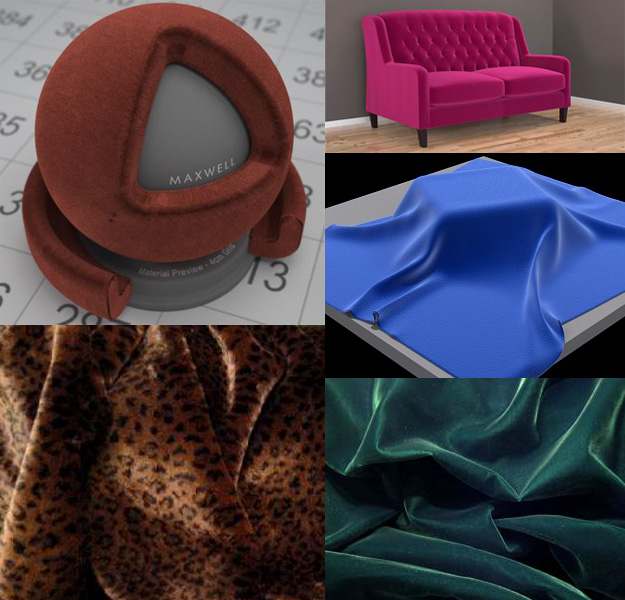

Post by Reinuvader » Thu Jan 27, 2011 12:36 am
I found something interesting from older topics:http://www.indigorenderer.com/forum/vie ... f=7&t=7505
Second picture is close to what I am willing to do. So how can I use this code. I tried it, but it doesn't work. What to do to get similar result?

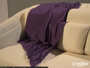

Post by CTZn » Wed Jul 13, 2011 1:23 am
I'm trying a different approach. Though it relies on bump mapping only it should be more accurate (I think). Bump code:
def eval() real :
(sin(texi() * 314159.27) * sin(texj() * 314159.27))
/ (31415.927 * 2.0)
Just playing with numbers, there's nothing scientific here :lol:

Re: Velvet shader
Post by CTZn » Wed Jul 13, 2011 5:31 am
I'm glad you like it, Nick. I'd like to experiment more before I matdb one :) but I saved an igm, let's see...
What's really exciting is that one can have as many responses to lights direction as he can code micro-patterns. Makes a lot of variations for a rather simple material. Will illustrate this.
That current pattern is about the most generic one.
PS: the shader is UV dependent, normally it should be tweaked for the scene for best results (density/length).
velvet.igm
(751 Bytes) Downloaded 443 times

Re: Velvet shader
Post by CTZn » Fri Jul 15, 2011 1:30 am
The bump shader I used is above the render (and the igm below ;P).
I didn't notice that... ehr, derivation. I've got anisotropic effects without noticing the pattern, though I took care not to scale the pattern down too much (proceeding by order of magnitudes, 10x larger and it should be noticeable).

Re: Velvet shader
Post by CTZn » Sat Jul 16, 2011 4:27 am
Yep Lemo, the combination of U and V threads renders duller than U or V alone wich have a more pronounced anisotropy, by definition. It's also one setting among one zillion :)
You guys want the one ready to go material, ok :D I think from now on I will release micro-patterns as one tile and it will be up to the user to take care of the UV placement, how does this sound ? Adresses my concerns with scaling, but you'll still have to learn to set bump value right...
Anyways, has someone tested that velvet igm already ? What gives, what wants ?

Re: Velvet shader
Post by CTZn » Sun Jul 17, 2011 5:33 am
Lemo wrote:Possibly a bit too close to cell-shading, but cool stuff !
I thought about it, and most probably that's because the "hairs" length is constant. I'll check this out in a moment.
