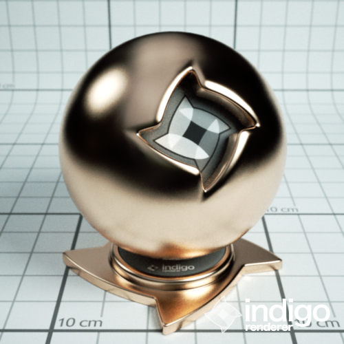

Post by delle » Thu Nov 05, 2009 9:21 pm
This is what I've got adding some gold to the "alloy".
This Material has 25% of gold inside (in effect it is a little bit expensive as brass :wink: )
EDIT Material composition: 25% Gold, 50% Copper and 25 % Zinc
Golden brass.png (285.46 KiB) Viewed 8824 times

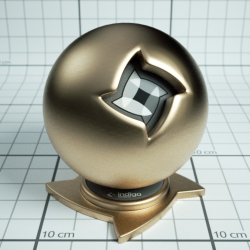

Post by delle » Thu Nov 05, 2009 10:40 pm
I've changed a little bit the composition of the Alloy, now it is:
Gold 25%, Copper 63%, Zinc 12%
Ottone 02.png (358.42 KiB) Viewed 8807 times

delle wrote:I've changed a little bit the composition of the Alloy, now it is:
Thats looking really good.
