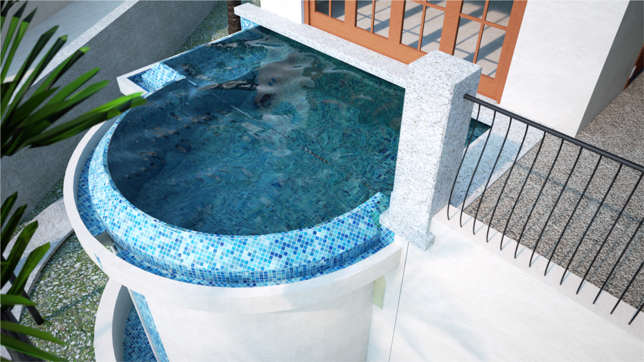

Man, I keep failing to get any caustics on my pool water. Any obvious reasons anyone can think of? I am following the SKindigo water tutorial to the letter. So far, nothing gives me the caustics. Also, takes forever to develop.

please share more infos about your scene, and if possible an example. Are you rendering with MLT?
And yes, caustics are a bitch considering render times...

I've rendered this pool from different angles and under different light conditions. Here I have two Light sources inside it, I like the texture and light filling the pool, but on the night or day scenes, I still get no caustics, even after an all night render time.
I suspect it is a mistake on my part, but I can't put my finger on it.

Anyway, I like this water and I think it is fine.
And perhaps I just don't understand the nature of caustics.
Weird split line on the pool. I dunno where that comes from.

I am no caustics expert either. BUT I would expect that in real life, there would probably be no caustics in your night scene, as caustics happen when a strong light source (=sun) hits the pool from above, causing caustics on the pool walls and floor by interacting with the ripples of the water volume.
So I would think that in your daylight scene, caustics should appear if
- the light source is strong enough and hits the water directly (perhaps you can play with the angle of the sunlight?)
- the pool has real ripples for the sun to deal with
How do you "ripple" your water? When using a displacement map, make sure the subdivison of the water is really high, and perhaps try another map. When using a shader, just play with the values to get more ripples/make the ripples a little deeper.
Rendering with MLT enabled (=using CPU only) should make the caustics appear early on.
Have you tried following the tutorial step by step, without the nice villa in the background?
Best of luck :-)

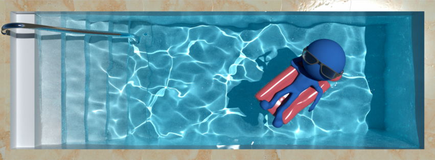

... just found an old render from 2012 which followed pretty much the tutorial, it seems to work ;-)

Thank you! Will tweak the subdivision and the sun angle and see what happens.
Cool image by the way! lol
