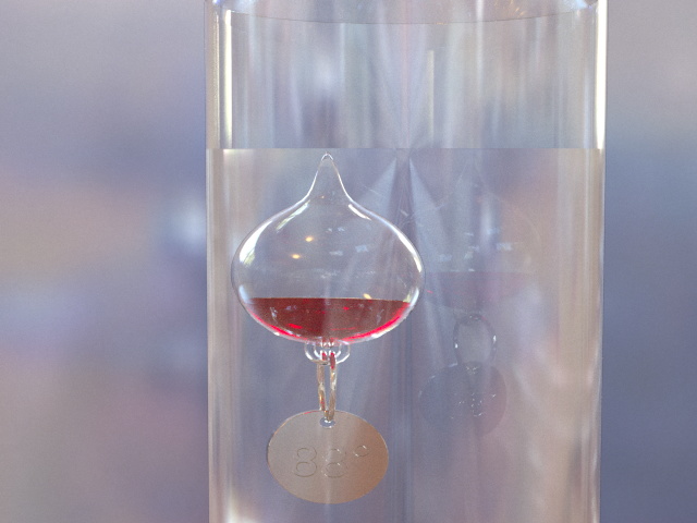

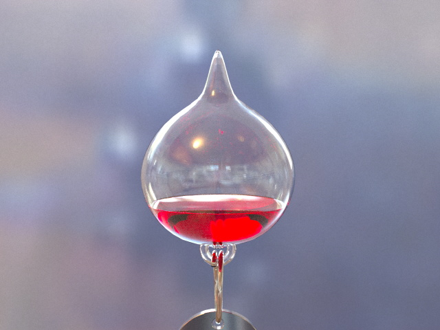

I've tried all sorts of precedence stacking, and this way comes out closest to real world. Normals are correct, model is entirely "Indigo compliant". (new term?)
Outer cylinder precedence is set to 1, water set to 2 and is extended into the glass just barely per nik's instructions. This works. The inner bulbs are set to 1 as they are should be displacing the same water and should take precedence, and the fluids inside them are set to 3. Because 2 made them black and have no surface reflections, although technically since they're still inside the water too that should have worked AFAIK just with no highlights. Oh well. But - look closely at the fluid inside the bulbs, you can clearly see the edges scaled in between the glass walls, which shouldn't happen as that's what precedence is all about. I thought perhaps I scaled the fluids too large, past the .2-1mm boundary, but no, I got the camera inside the bulb and scaled the fluid until it -just- disappeared under the inside surface. And, rendering the bulbs without the water and glass column in the scene, the displacement happens as expected. So - why did the glass bulbs did not displace the internal fluids? Does nesting displacements with precedence not work?
Another nasty (annoyance, really) is that colors don't work at the same level. Red is 50, but trying to get each of the other colored fluids to match in color density requires tweaking each one individually. Yellow is 75 and green is 10. Orange is nearly brown at the same gain as red. Blue is the worst, at 1 it's nearly clear, 10, it's slightly blue, but 25 and it comes out purple?? Also, you'll notice the colors inside the glass are blown out completely.

Post by OnoSendai » Tue Oct 02, 2007 4:52 am
Your precedences are all wrong.
try this:
Outer cylinder glass: 2
main water: 1
droplet glass: 12
droplet air bubble: 10
droplet liquid: 11

Post by Heavily Tessellated » Tue Oct 02, 2007 5:49 am
OnoSendai wrote:Your precedences are all wrong.
try this:
main water: 1
droplet glass: 12
droplet liquid: 11
Great, there's my new sig.
Firing one off as the above. If this works, I guess I need more instruction re: precedence and displacement than what the WIP manual contains. So much for volunteering to document something you know nothing about. :oops:

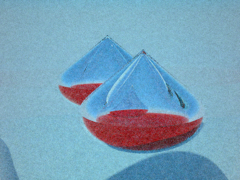

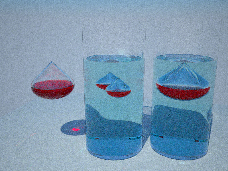

Post by DaveC » Tue Oct 02, 2007 8:46 am
Make the glass ball precedence ten. make sure to check all of your normals.
Make the liquid inside the ball precedence 8
make the air (over lapping glass and water) precedence 7
make sure to check all normals on liquid and air point outwards.
Drop the whole thing, glass, water and air, in another liquid. Give THAT liquid precedence 6
Put that liquid in a glass cylinder made from the original glass.
Don't forget those normals ;)
Make sure all mediums are closed volumes and the glass ball and glass cylinder have solid walls with thickness.
and now it should work thusly...
close up
three stages
