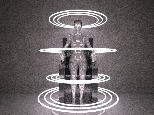

I'm back once again to beg help from those with more wisdom than myself. Right now i'm doing a frame from the movie 'metropolis', which i suppose it kind of funny since i'm using metropolis light transport to do it.

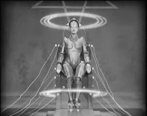

This image is very preliminary, i'm just setting up composition and lighting at the moment, no love to the models yet. The problem i'm having now is trying to figure out how to do the 'energy rings'. I'll post the screencap from the movie since the movie is now public domain so you can compare. What i need is a way to make them semi transparent.
I tried to blend an emitter and a null but all i got was a null. any suggestions on how to achieve this effect? maybe an SSS texture with an ior of 1 and very low scattering with a thin light ring inside the torus? has anyone tried anything like this, advice would be greatly appreciated. I can't even figure out how to do it in post production.

- screen cap from the best movie of all time
- best_shot.jpg (19.6 KiB) Viewed 16690 times
- my first test render
- im1203688808.jpg (89.84 KiB) Viewed 16690 times

sorry, the only way to do it currently would be to render it twice, once with and once without rings and then blend the image as needed
You know: Emitters aren't materials.
*ANY* Emitter actually has a black diffuse material, which doesn't reflect (or refract) any light at all.
What you'd need, is a volume emitter, which isn't yet implemented in Indigo.

but they wont be generating light , so the materials that you can see through the rings, will be considerably darker than they would be in the second image, the one with the light rings. when i go to blend the images together wouldn't it look like the materials behind the light rings were darker? its hard to describe what i'm saying.
lemme try again
image 1 = image with transparent diffuse rings
image 2 = image with light rings
image 3=image 2, with image one layered over it using a mask of the rings, so there is transperancy.. right? it seems like anything behind the rings would be too dark in image 1
i'm running a test now with a transparent torus filled with smoke, and a very thin filimant of light. But i think i'll try this method as well , just to see what the results would be.

they are not the only light source, but they are 5 to 10 times brighter than the others.. and yeah ,that was what i was trying to say. I've been sick with the flu and its messing with my head, sorry for being hard to understand.
the SSS transparent tubes with thin light filaments produced a beautiful image, but it had flaws i didn't want to mess with, plus it would have taken forever. but i think i've found a post pro method that will provide adequate results. rather than blending two images, im just rendering the rings really thin, and then using the gimp to dilate and blur them.. so the edges blur into the image.

Neobloodline I considered using blender to do the rings. but even with all its new features in the upcoming version (and it has quite a few nice ones, love the blurred reflections) its still a biased rendering engine. indigo just has a quality about it that is really , really hard to get with other raytracers. for instance, making high res toroid area lights in blender doesn't sound like fun
that being said i did think of using blender to do halos for the rings, and then layering them on the indigo rendered image, but i was concerned that the images would clash.. they wouldn't match up properly color wise.
i will how ever, i think, be using blenders nodes to blur the final rings using a mask.

thats not a bad suggestion, i considered that too, in fact this was my first plan before i decided that just post pro would be the easiest route. since my scene is modeled in blender, using it to do post production with its wonderful node system will be a snap, and my test came out pretty decent.
now i'm on to modeling the robot, adding in the power cables, setting up the composition.
Do u guys think that i have too many rings in my version? should i reduce it to two sets?
