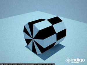

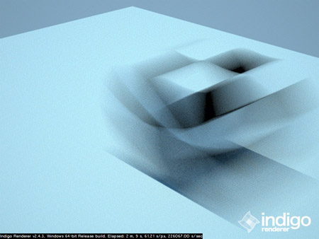

Post by Doug Armand » Fri Jun 04, 2010 10:51 pm
Bug: Motion blur not working
Blender 2.5 1/15 sec shutter speed. Object & Camera Motion Blur enabled
Blender 2.49 1/15 sec shutter speed. Object Motion Blur enabled
Although I'm not sure that the 2.49 version is correct. The cyclinder is just rolling toward camera - strange motion blur effect for just that I think?
Doug

Doug Armand wrote: [Indigo 2010-Jun-04 11:53:07] 'Scene' object has no attribute 'indigo_camera'
I've located this problem, it is related to the camera ISO value when using camera tonemapping.
As for motion blur not working (in 2.5), well that's because I haven't actually implemented it yet ;)
[As for moblur in 2.49 - please can you report the problem in the 2.4 thread, thanks :) ]
