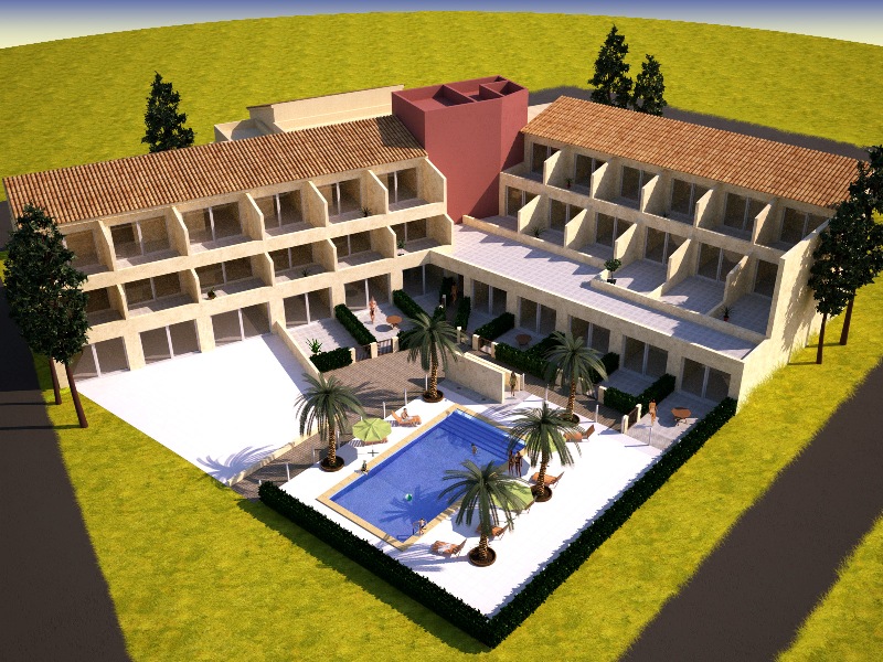

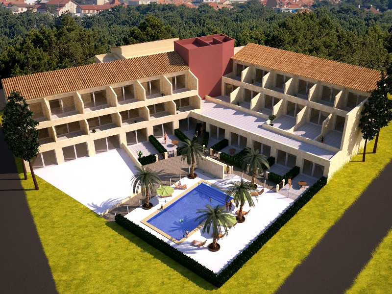

Post by zeitmeister » Sat Nov 07, 2009 9:25 am
Aaaalright... I'm starting! :mrgreen:
- The pool water color does look ill; it should be more turquoise, healthier.
- Tiling of the floor on the left at the back is too strong, look for another texture... maybe something homogeneous.
- The hedges are looking too uniform.
- Your palm trees need something to grow in, they are just placed on top of the wood floor... think about notches!
- Palm tree leafs need to be reworked; look here and here.
- And maybe the most important point: Correct the perspective!
Your actual camera position does apply some kind of toy model impression to the whole scene. You sould lower it a lot at eye level.
Hope it helps! :D
You asked for it! :mrgreen:

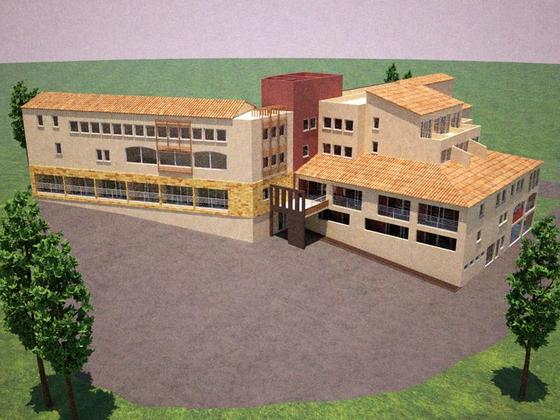

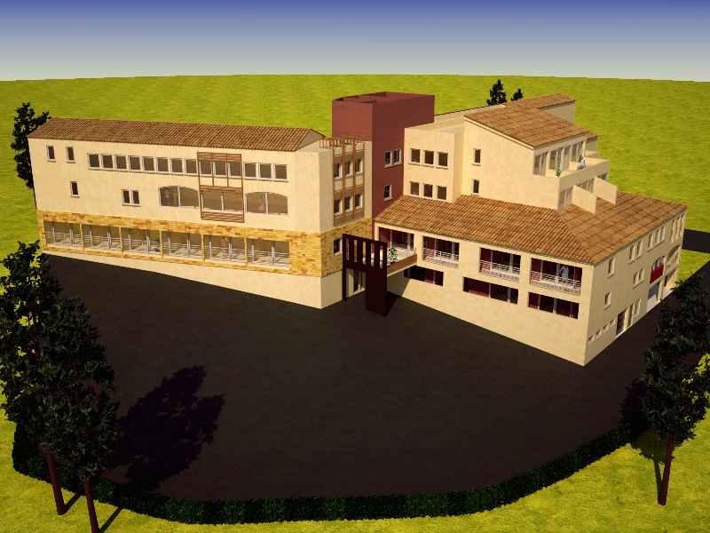

Post by madcoo » Wed Jan 06, 2010 1:46 am
Hi everyone!
HAPPY NEW YEAR TO ALL !!!
Here are the latest pictures...
I'm still struggling with several issues, but little by little I'll get there...
I've got several questions:
1) I sent the files to a friend of mine. He told me that the tarmac and the trees/hedges look extremely dark, close to black. Does it look the same to you? In which case I'll have to lower my screen's brightness...
2) I think the point of view (chosen by the client) is not really right for the first view (with the swimming-pool) : it's way too high above, what do you think? (i already think ZeitMeister will agree :wink: )
I'm trying to get him to understand that a lower point of view (like the second view) would look better.
3) Clipping masks : I had a look on the web, it seems that this method helps a lot with integrating 2D background images in 3D renders. I had a look at the technique, it doesn't look much complicated... Do you often use it?
Well... as always, many thanks for you help!
:D

Post by madcoo » Wed Jan 06, 2010 7:47 pm
Hi!
I worked again on the project : I modified the colours so they don't look so "bright", and got rid of the hedges because they looked so "repetitive".
I think it's already better this way - what do you think?

Post by dcm » Wed Jan 06, 2010 10:41 pm
its nice but try to use more contrast. Some glass materials, some phong,some textures,blueish sky and yellowish light inside the building...there is a lot of combinations how to achieve realistic look. For the first u need to play with materials ! 8)
look http://www.evermotion.org/vbulletin/sho ... hp?t=78186 or http://www.evermotion.org/vbulletin/sho ... hp?t=78200

Post by madcoo » Wed Jan 06, 2010 10:46 pm
Thanks for your advice, as always!
:wink:
Indeed putting some spotlights inside the building would help lots...
I'm also working on some bushes and flowers.
I much prefer the colours I used in the latest picture - less "flashy" so to speak - what do you think?
