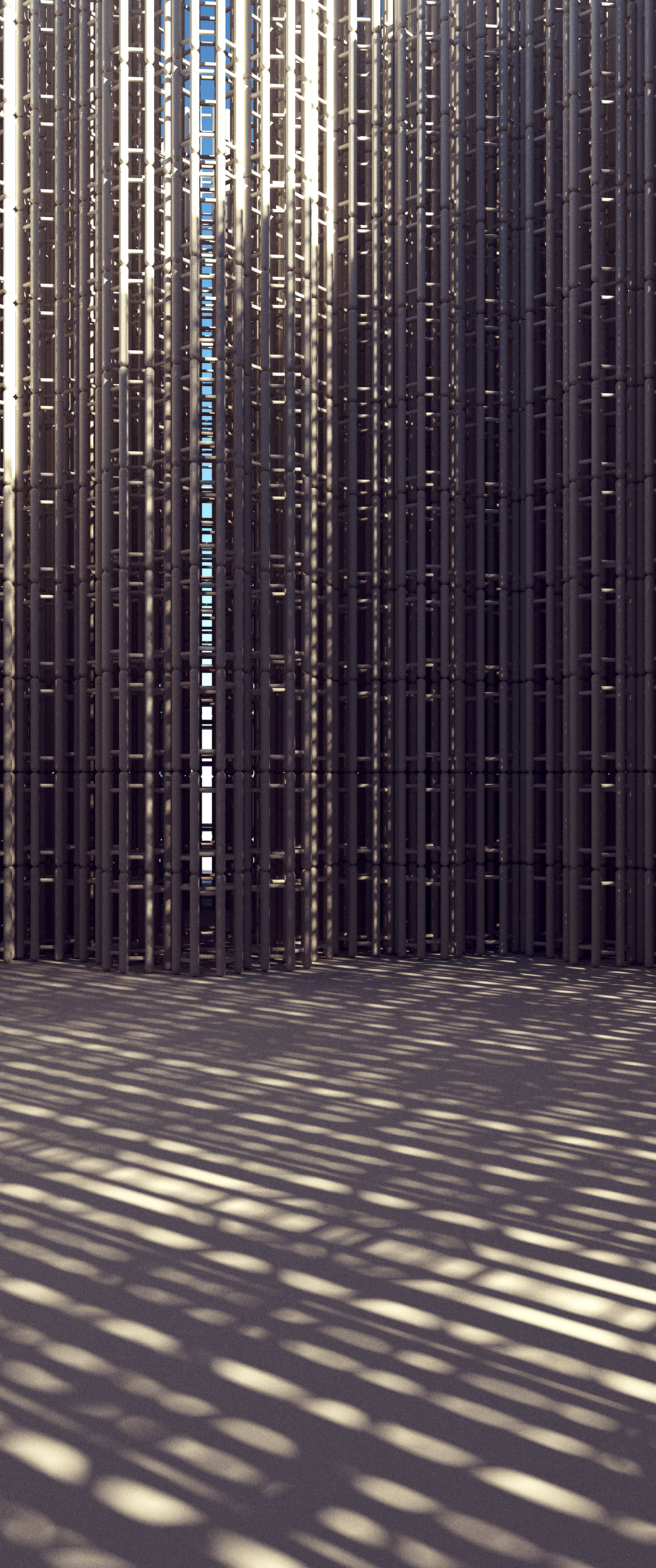

11h 23min. A masterpiece of light. Only possible with indigo. Not finished indeed, better. Some space to imagine. With problems with model and smoothing... the same, a masterpiece of digital artesany. If you love indigo for a reason, this is one of this...

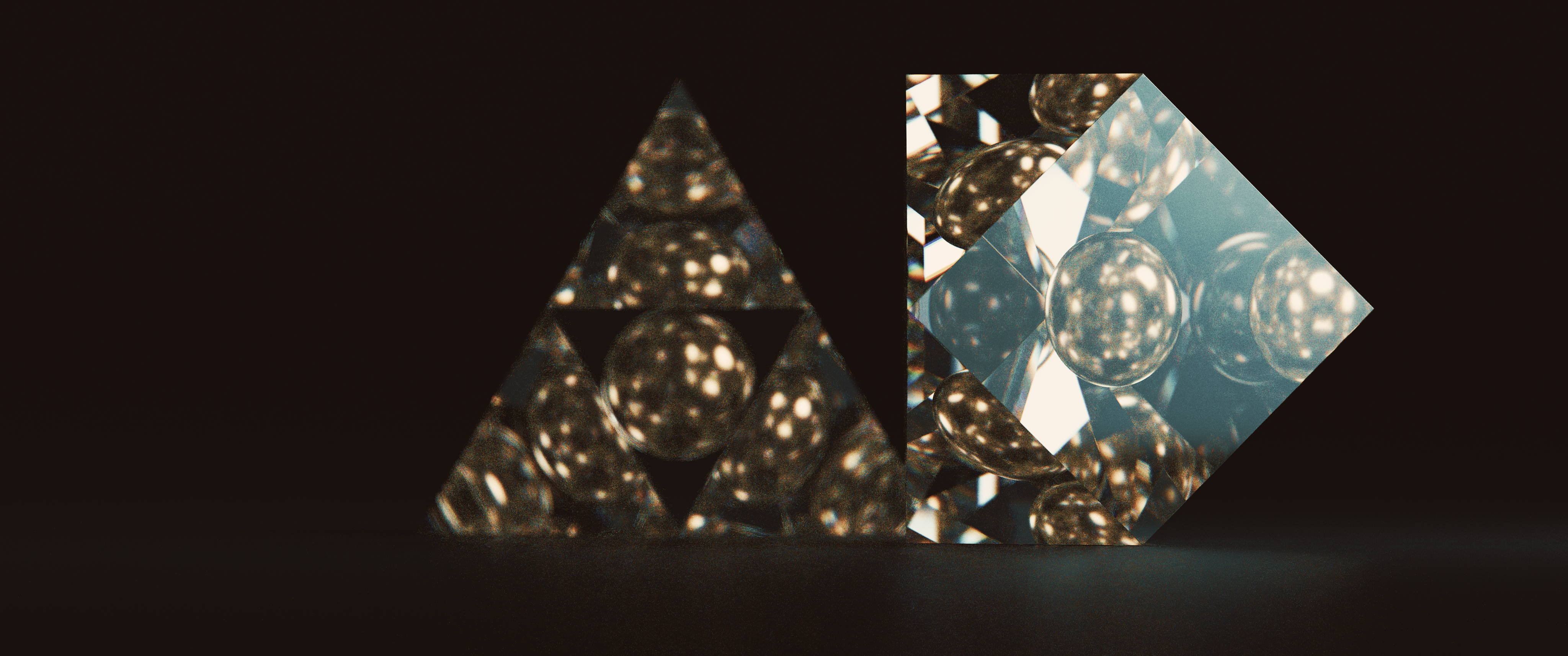

80 hours of render, +63K samples per pixel ... perfect spheres are in this way ... The concept is essential and exact. Try to poligonize the spheres and you got a perfect image in 20 hours (but not this apperture diffraction). The HDR manipulation is needed to see all the light process but dirt a lot the solution. There is to see what must be seen (erotic). Perfect spheres don´t work in indigo 4.6, try 4.4 sereies or the first 4 series for physical apperture. :)

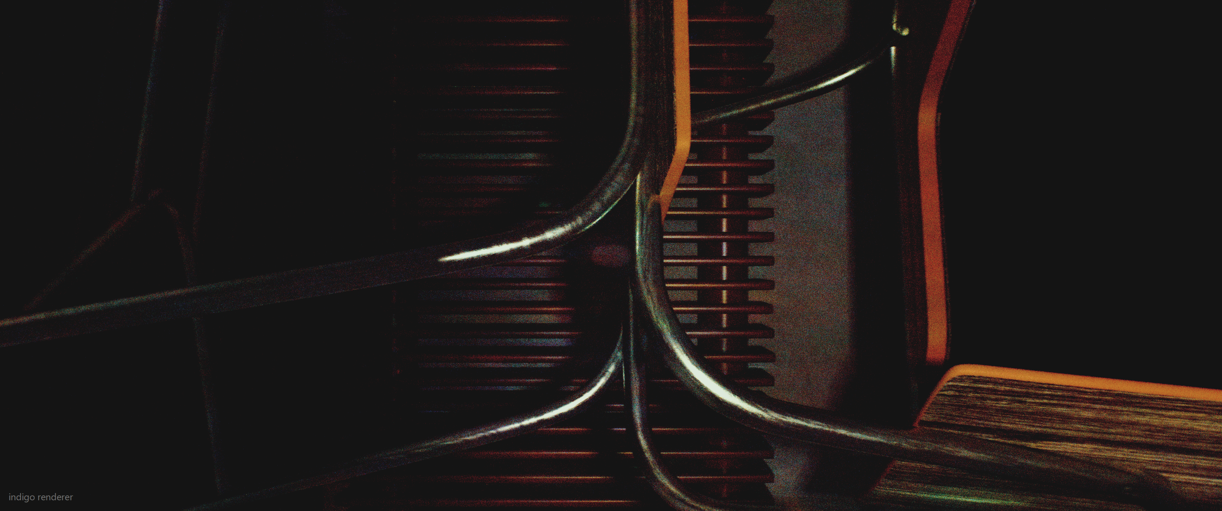

9h pure 4K.
40h pure 4K.
0:30 h pure 4K.
Bronzes, the origin.pigs
(35.03 KiB) Downloaded 804 times
If you obtain a cool picture from whatever scene I was posted, please hang it here and we talk about :)
