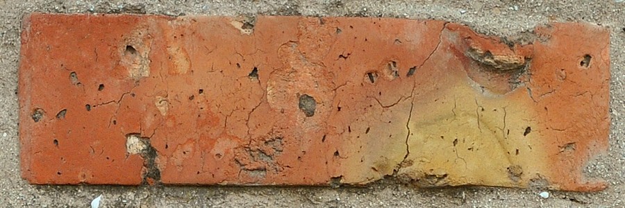

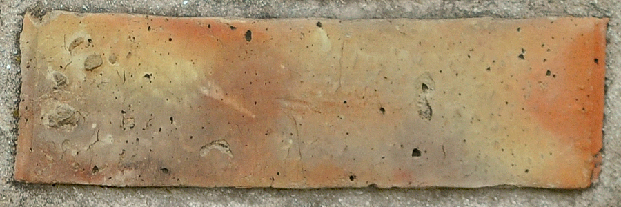

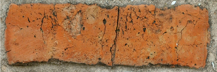

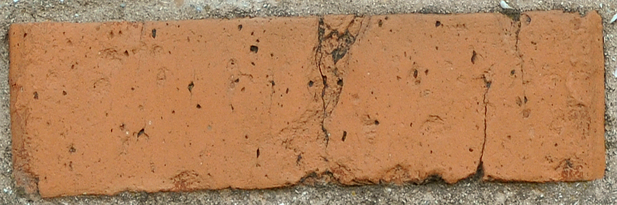

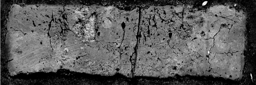

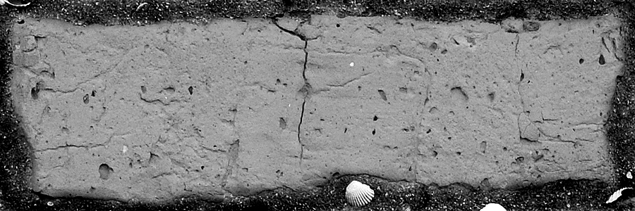

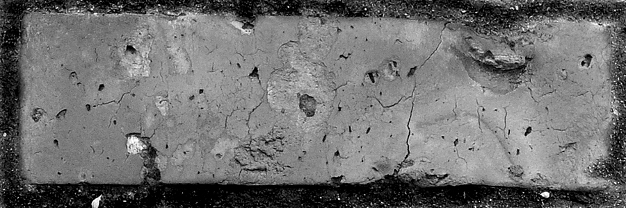

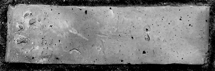

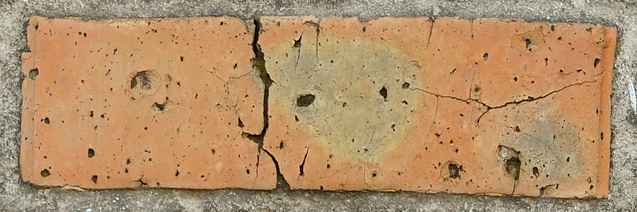

Right... I'm out of my depth here... :oops: I'm afraid I just don't know ISL at all...

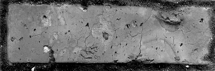

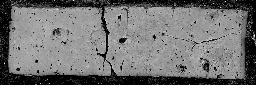

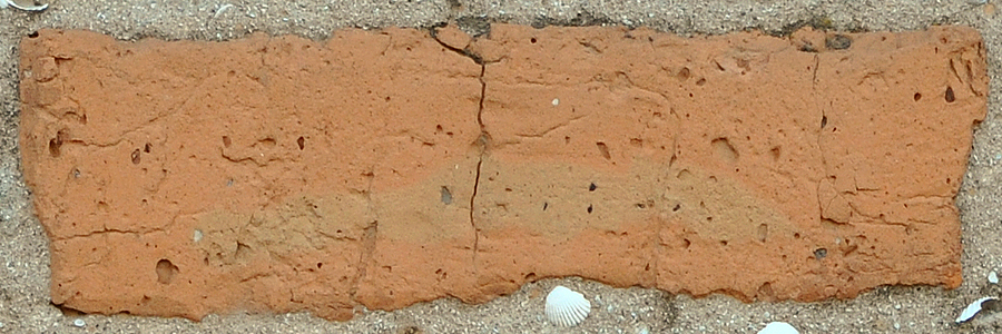

I've managed to get the diffuse sort of working with 6 different maps, although some of the images are stretched / distorted for some reason... with non square tiles, we would want to just have the mirror on x & y and no rotation.

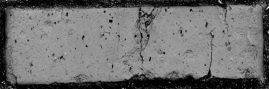

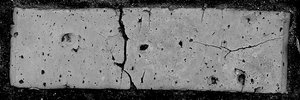

Also it would fantastic if the same sort of code could be used to link each randomly selected diffuse map to it's corresponding bump / exponent etc.
If anyone who actually knows what they're doing wants to have a go at this I think it has great potential. I've attached below individual diffuse and bump / exponents for anyone who fancies a crack at it...

Some of the diffuse maps still seem to be getting distorted, any idea what might be causing that?
edit
* sorry my fault, forgot to delete the old unpacked files... works fine!

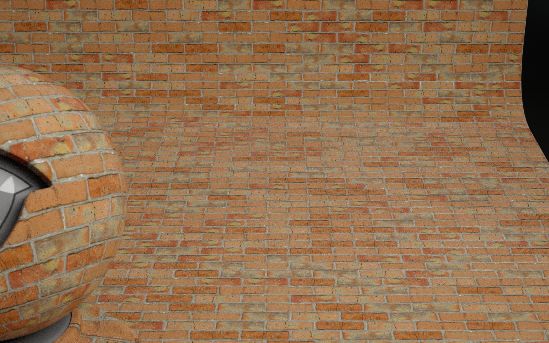

Re: Random Tiles
Post by OnoSendai » Thu Jun 05, 2014 12:37 am
Here's what it looks like here:
