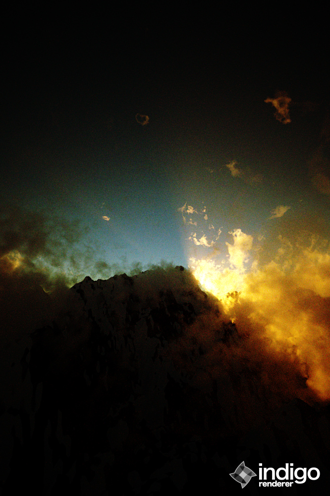

yonosoy wrote:Zenith 88.3, 5.3K spp.
Thanks for the strong demand (not super clean for the chromatic). Super clean for the next try, this is a metropolis test ...
So glad to hear you Oscar, thanks a lot.
CTZn will be great to serve you as tester when you come back. Meanwhile...
The most exciting part is that the pigs is about 4KB of weight.
Can u share IGS from last one ? i`d love to cook it at 10k

Re: A natural situation
Post by Zom-B » Sat May 10, 2014 1:06 am
Here a 10100s/px rendering of the "High_mountain_13.2.pigs", after 4.45h on 3 x 4770k machines.
Sadly MLT isn't that strong on the long run, so the enhancements in the last hour(s) where quite subtle...
The IGI can be downloaded from here: https://dl.dropboxusercontent.com/u/693 ... n_13.2.igi

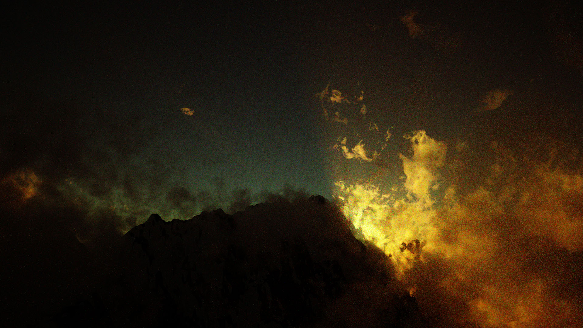

Post by Oscar J » Sat May 10, 2014 1:16 am
Damnit, I want a wallpaper size one. :( Why is it rendering so slowly?
Post by Zom-B » Sat May 10, 2014 1:25 am
Oscar J wrote:Why is it rendering so slowly?
Atmospheric scattering is used here and some inhomogeneous SSS media (clouds) with some freaky procedural noise. This is painful for every Renderengine, if you find another one even capable of rendering such stuff ;)
Post by OnoSendai » Sat May 10, 2014 1:26 am
Try it without MLT.

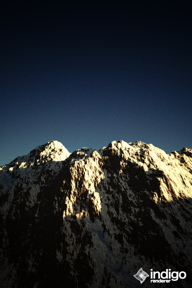

Post by Zom-B » Sat May 10, 2014 2:38 am
Here a quick 1h rendering with PT up to 630s/px in wallpaper scale (changed some camera aspects here):
Post by Oscar J » Sat May 10, 2014 3:29 am
Hey, that's not bad. Is it slowing down, or would it be clean overnight?
Post by Zom-B » Sat May 10, 2014 3:32 am
Oscar J wrote:Hey, that's not bad. Is it slowing down, or would it be clean overnight?
PT shouldn't "slow down" over time just like MLT does. But I actually don't have free CPU-time here to render that, since I have some animations in the pipeline atm...
