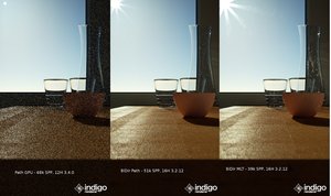

PigsOnTheWings wrote:First render with Indigo, testing how long Path (gpu) takes to clear up. This is @13h and 29k samples.
Hi PigsOnTheWings, and welcome !
You have been using an IES light profile is it ? Is this using Indigo 3.4.0 ?

Very nice and useful test scene!
..I'd rather have tried with another film setting though..
Post by lycium » Mon May 28, 2012 9:02 am
And with bi-directional path tracing, not GPU single-directional :)

Post by PigsOnTheWings » Mon May 28, 2012 10:27 am
Thank you :)
I've been using IES lights, but I had to severely limit the light layer (seems all my IES overpower the scene). Camera setting would be a good idea, figured it out some time after rendering this.
For this test I used 3.2.12 since blendigo produces an error with 3.4.0. In the mean time I've begun exporting scenes to 3.2.12, then saving them and opening them in 3.4.0.
I tested this scene with BiDir MLT, cleared up a bit faster. I've edited this scene to try out the sun and sky system. Working on it now.

Post by PigsOnTheWings » Thu May 31, 2012 10:50 pm
I've run a few tests, with BiDir Path, BiDir MLT and GPU. I used the tip from Headroom about the spec map, though it seems to make a strange effect. Picture says it all :)
3 Render modes, same settings. Scaled down from original pictures.
Post by CTZn » Fri Jun 01, 2012 2:19 am
The result is a bit drastic indeed, probably the map used is too noisy itself...
Primarily one would use the specular map as a phong's exponent. At this point and since a texture ranges from 0 to 1 by default, it is necessary to use the B (gain) and C (offset) texture parameters, because an exponent ranging from zero to one is nonsense.
The gain parameter will multiply the texture values, and the offset value will be added on top.
If the exponent should range between 60 and 800 for instance, the C value should be set to 60 (texture 0 + 60 = minimal exponent value) and the gain to 740 (because 740 + 60 = max exponent value).
In other words, B specifies a range and C the position at wich it is starting.
Both can be negative in certain cases, ie B = -1 and C = 1 would invert any texture.

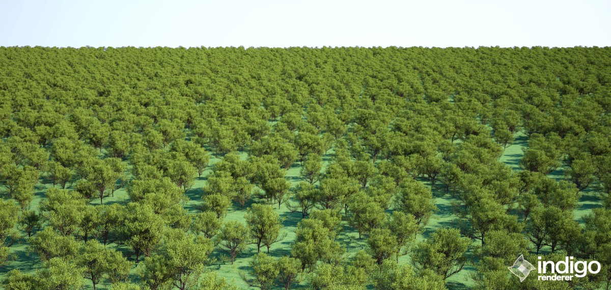

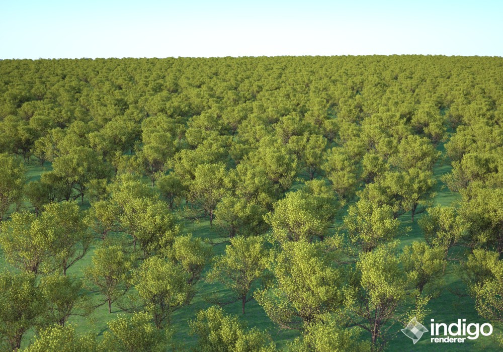

Post by Gabich » Tue Jun 05, 2012 2:39 pm
Just a litlle test:
Doug Armand
Posts: 1038
Location: London UK
Post by Doug Armand » Tue Jun 05, 2012 6:53 pm
Nice! tell us us more about what you used :D
Doug
Doug Armand
Gabich
Posts: 19
Location: France
Post by Gabich » Wed Jun 06, 2012 10:21 am
There is only one tree intanced with the system particles of Blender. Each render was done in 10 minutes ( gpu render) for a total of 574 000 000 faces. It's only a test for another render (based on an old model than i rendered with Yafaray):
