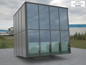

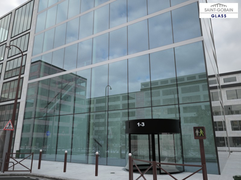

Dear Indigo users,
During these last two years, Saint-Gobain Glass R&D worked with Glare on architectural coated glass rendering. We developed specific proprietary material models to provide an exact description of the complex interactions between the coating and the glass.
You can find example images of one coating below.
We will release these materials very soon, so that Indigo users may render glass buildings with extremely realistic coating models. They will contain a proprietary encrypted model of the glass spectral response.
Best regards,
Etienne Sandré-Chardonnal
Saint-Gobain Recherche

Looks awesome! Looking forward to taking it for a spin.
Re: Coated glass models - SGG/Glare development
Excellent news! Thank You so much for your involvement in this!
Cool! The coating looks great. Thank you for sharing.
Wow! Very cool!
