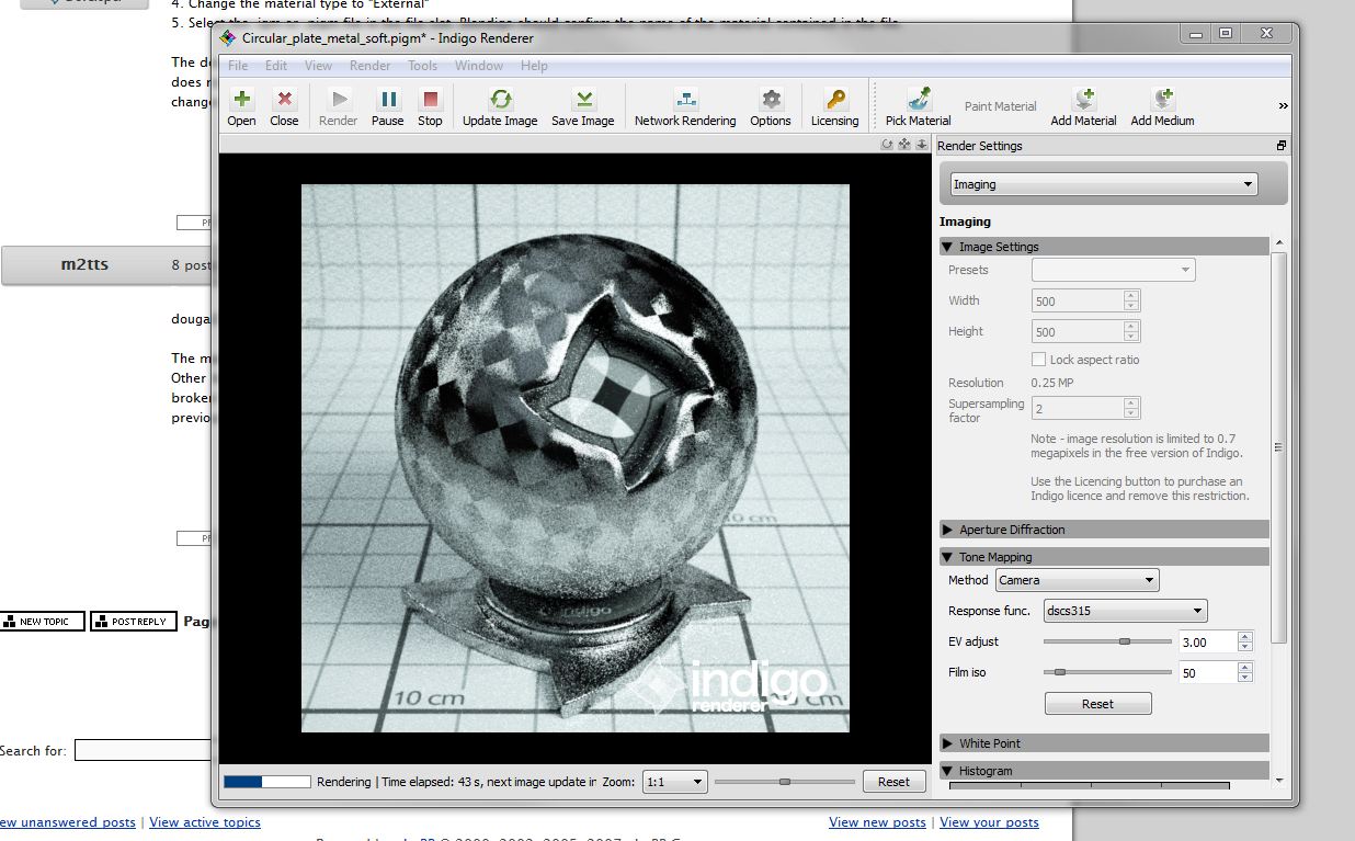

I just downloaded CTZn's .pigm file, and it opened directly with indigo and started rendering See attached image. Downloading and rendering like this has nothing to do with Blender or Blendigo. What did you do exactly after you clicked CTZn's link? Which file did you download?
Also, which versions of Indigo, Blendigo and Blender are you using?

http://www.indigorenderer.com/materials ... 2/download
This is the direct link to the file CTZn posted and it is a .pigm...
