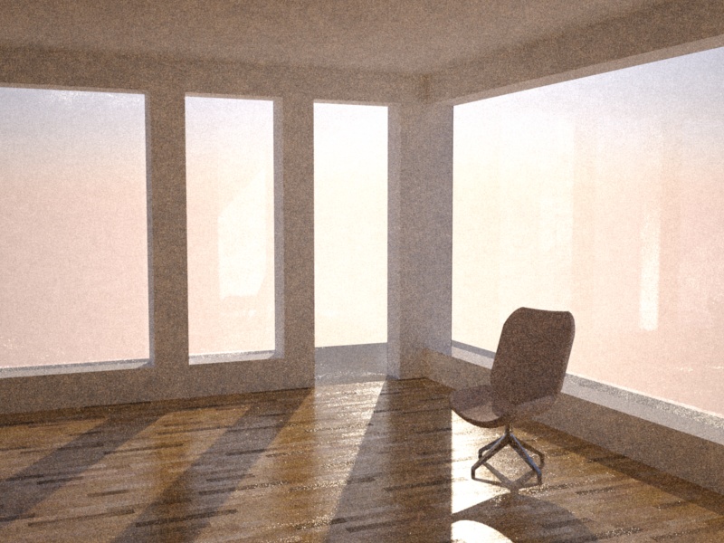

Hmmm, interesting. Just tried to recreate your scene quickly and got this - I assume you're looking to have the sunlight slanting through the windows in 'bars' a bit like the image below? This model uses ghost glass in all the wall openings and the sun still seems to come through.
Some stuff to check:
1) Really obvious, but I assume your model is positioned so that the sunlight is actually shining through the windows in sketchup?!
2) Set your ghost glass on a single face - don't give it a volume. I believe its one of the 'thin glass' materials that can do this, the others all need to be on a volume. The image below, the glass in the windows is on a single face.
3) The default material in sketchup looks white, but actually renders a sort of grey which can darken scenes a little - change your wall coverings to a white material (but not pure 255,255,255 white, knock them down a little, too white and you get fireflies - spots of white in the image - I believe) which may help lighten up the interior.
4) Ditch Reinhard rendering which tends to flatten contrasts and shadows a little - when rendering in Indigo, have a muck about with the cameras in the tone mapping section of the imaging tab (on the right of the screen). My screenshot is an Avantix100CD with 50 ISO which just improves your contrast somewhat.
5) Last thing, particularly with the evaluation version of Indigo - you're rendering at a lower resolution which can sometimes hide the shadow detailing until the image updates a few times, so try leaving it a little longer and see if your sun is more obvious.
Avantix100CD, 50ISO, BidirPT

1) In fact, the light is supposed to come through the windows on the right (see image below without windows).
2) The ghost glass is set on a single face. Did you apply the ghost glass "paint" on both sides of the face?
3) I already downloaded a material for the walls and I'll change them later, as I don't think it affects the light entering the room.
4) I currently use the "Camera" mode, but I use the Reinhard method too. I'll try different settings
5) The image below has rendered for about the same amount of time and you can clearly see the difference with the scene with windows.
