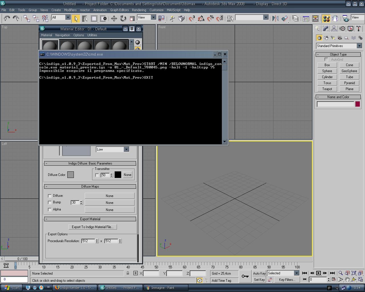

Post by filippo » Mon Apr 14, 2008 9:41 pm
A user of maxigo seid me that the material preview don't work...
what is the problem?
filippo
sorry for my poor language
error
Post by suvakas » Mon Apr 14, 2008 10:27 pm
What does the error message means exactly?
Seems like it can't find indigo_console.exe from Mat_Prev folder?

Post by saxophone » Mon Apr 14, 2008 10:37 pm
Hi, I can translate the phrase "impossibile eseguire il programma specificato" as " Impossible to execute the program specified"
that I think should be the console.exe

Post by suvakas » Mon Apr 14, 2008 11:01 pm
saxophone wrote:Hi, I can translate the phrase "impossibile eseguire il programma specificato" as " Impossible to execute the program specified"
Hey,
See if you have the console.exe in that folder.
Also (as a general tip) use only "good" characters in material names. Indigo doesn't like foreign symbols and such.

Post by suvakas » Tue Apr 15, 2008 12:12 am
If the .exe is there and it still doesn't work, then post the material_preview.igs file from the same folder. I'll take a look at it.

Post by saxophone » Tue Apr 15, 2008 6:47 am
suvakas wrote:If the .exe is there and it still doesn't work, then post the material_preview.igs file from the same folder. I'll take a look at it.
Hi, the indigo_console.exe is in the mat_prev folder.
I've changed the 02_default material name in "teapot" but doesn't still work fine
I attach the material_preview.igs file
(17.43 KiB) Downloaded 405 times
Post by suvakas » Tue Apr 15, 2008 9:24 am
Eh..sorry, my bad :oops:
I need to have the prev_mat.igs file and not the material_preview.igs
Can you please post the prev_mat.igs?
Or even better, you could pack the whole directory :wink:

Post by suvakas » Wed Apr 16, 2008 3:05 am
Thanks Saxo !
I think I found the problem. Maxigo probably doesn't automatically copy the required dll's from indigo root folder to Mat_prev folder. These are needed for console.exe to start. See if you have the dll's and if not, then you can copy the dll's manually from Indigo's root to Mat_prev folder. Take all of them.
[edit]
Actually I don't have Maxigo here at work, so I'm not 100% sure if Maxigo copies the dll's or not? But check out if you have the dll's in the Mat_prev folder

Post by saxophone » Wed Apr 16, 2008 3:15 am
Thanks for your reply. Now I can't check because I'm at work, but I'm quite shure that the DLL files are NOT in the folder.
This because the RAR file that I posted yesterday night is the complete folder that was in my Indigo.
I'll try your solution and I'll give an answer as soon as possible :wink:
Post by suvakas » Wed Apr 16, 2008 3:50 am
saxophone wrote:This because the RAR file that I posted yesterday night is the complete folder that was in my Indigo.
Sutpid me, of course :lol:
Yeah, then those missing dll's are the problem. Will have to check that part in Maxigo.
