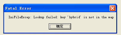

the last exporter don't work with indigo 0.8
Post by filippo » Mon Apr 30, 2007 3:23 am
the last exporter don't work with indigo 0.8?
Post by suvakas » Mon Apr 30, 2007 3:25 am
Why?
What problems do you have?
Kosmokrator
Posts: 1141
Location: Greece-Athens
Post by Kosmokrator » Mon Apr 30, 2007 3:38 am
for me just work perfect!
filippo
Posts: 658
Post by filippo » Mon Apr 30, 2007 3:41 am
"fatal error"
"inifileexcept:lookup falied:key "hybrid"is not in hte map"
what is it?
thaks
filippo
Kosmokrator
Posts: 1141
Post by Kosmokrator » Mon Apr 30, 2007 3:42 am
r u change the indigo path to 0.8 indigo.exe?
Post by suvakas » Mon Apr 30, 2007 3:52 am
Yes, do what Kosmo wrote..
Be sure you have the correct Indigo 08 path in Maxigo/Indigo Setup rollout.
Also check if you have 08 ini file under Indigo08/Exported_From_max.
It should get copied automatically, but maybe you did something wrong.
Kosmokrator
Posts: 1141
Post by Kosmokrator » Mon Apr 30, 2007 4:01 am
i think may have the old 0.7 ini file for 0.8 and did not find the hybrid tag....sure this may help fillipo...
filippo
Posts: 658
Post by filippo » Mon Apr 30, 2007 4:04 am
I am a sputid!!!!!!!!!
the problem was the incorrect Indigo path!!!
if I want turn on the new mode, I worte true in the txt file?
thaks

Post by Xman » Mon Apr 30, 2007 5:21 pm
Hi suvakas,
I have the same problem, can't work. :(
thx!
Intel i7-920,RAM 3G ,GeForce 9800GTX+.
Post by suvakas » Mon Apr 30, 2007 6:53 pm
well..i have the same advice - see if you installed 08 correctly.
I can't think of anything else cause i can't re-create that error myself. I tried to use 07 ini for 08 and vice versa, but i don't get that error.
[edit] If you are sure, that you installed it OK, then send me the ini file you have in your Indigo_08\Exported_From_Max directory.

Post by Xman » Mon Apr 30, 2007 7:05 pm
Thanks suvakas.
Now can work.
My method is:clearance(Exported_From_Max) and install (Maxigo-07) again.
Maxigo-07 can't command hybrid,Wait for your new exportation (Maxigo-0 8). :wink:

Post by suvakas » Mon Apr 30, 2007 7:21 pm
Glad that you got it working, but you don't need to re-install Maxigo. When you want to change your Indigo version, then all you have to do is to change the Indigo location from Indigo Setup rollout under main Maxigo exporter dialog.
About hybrid. I think it should be ON by default in 08_test1. Are you sure you are using 08 and not 07?
You can turn hybrid on and off by editing the ini file in Exported_From_Max folder.(I'll try to add those new options into Maxigo soon.)

Post by suvakas » Mon Apr 30, 2007 11:05 pm
suvakas wrote:About hybrid. I think it should be ON by default in 08_test1. Are you sure you are using 08 and not 07?
Ups..my bad. Hybrid is set to "false" by default. So you were right 8)
