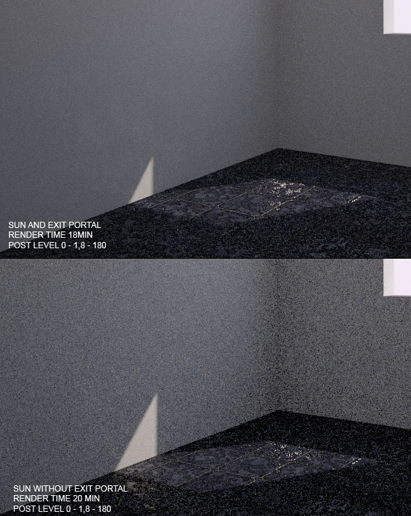

Hi, I just wanted to share with all this a simple test that shows how important the use of the exit portal. :D

How do i use an Exit portal?
*Edit Nm i figured it out!
Good to know thanks!

very simple, just create a box in Max with size of the window and apply the modifier "exit portal" and voilà! :D

thnx to suv to implement it so good via max exporter...btw...an bug or neseccery bad thing is the direction of light is not the same after the exit portal apply.... :wink:

a box?
Usually, a plane is enough...
The normal should point through the window, inside.

Kram1032 wrote:a box?
Though, there're some problems: For example, if you have a veranda or any kind of outdoor models, they wont be rendered ;)
Do a bigger box then ;-)

Post by Kram1032 » Wed Jan 30, 2008 2:49 am
Yeah, you can do a bigger box (or plane...)
The geometry should:
  • be as simple as possible
  • perfectly go over the whole "hole"
  • have it's normals pointing in the direction the light is supposed to go.
If you let holes, you'll see black frames (at least when using BiDir)
If you make it too big (for example a big cube over the whole scene), the time increase will be far too minimal.
If the geometry is very complex, it's not as efficient.
If the normals point in the wrong direction, no light will come through them. They'll render as black walls (at least with BiDir)
