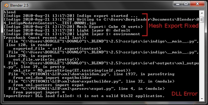

However, due to recent API changes? In indigo\properties\object.py line 38:
'normal_smoothing': [str(self.context.data.autosmooth).lower()],
must become
'normal_smoothing': [str(self.context.data.use_auto_smooth).lower()],
at least this change made it work for me :)
and after which I get a DLL error :S

The DLL error is because you're mixing 32/64 bit code.
Make sure that your installed python distribution matches the architecture of your blender build.
I will take a look at fixing the API changes soon.

I re-installed python 3.1 (x64 this time) and the last line became of the error last screenshot I posted is now:
ImportError: DLL load failed: The specified procedure could not be found.

Borgleader wrote:I re-installed python 3.1 (x64 this time) and the last line became of the error last screenshot I posted is now:
I'm not sure what that error means, but after a bit of googling, it would suggest that your python installation is trying to load code from a mis-matched version.
Do you have any other copies of python installed on your machine? If so which ones ?
Did you actually perform an uninstall of the 32bit python before installing the 64bit one ?
Did you remove any 'left-over' bits of the 32bit install before installing the 64bit one ?
The library that is failing to load is the one which handles only the formatting of the XML/IGS data into the scene file. It seems that the actual building of XML data is working, it is just the final step before file write that fails.
If the python problems remain, we could try disabling the XML formatter (which means hard-to-read code if you need to edit the IGS by hand) and see if you can get at least the 'raw' XML written to disk.
BTW, which version of windows are you using ?

a) No I hadnt uninstalled the 32-bit version because when i ran the installer for 64-bit it detected the older version so I thought itd be fine
b) I used CCleaner to run the uninstallers for both 32-bit & 64-bit python 3.1 installs. And then ran the 64-bit install again. Same error.
c) Windows 7 64-bit
If it's something on my end and not related to the code than I'll keep working on it 'till it's fixed :)
Edit: Deleted Python321 folder & ran uninstaller. Export works now because it seems to be using the bundled python instead :? Auto-start seems to not work though.

Borgleader wrote:a) No I hadnt uninstalled the 32-bit version because when i ran the installer for 64-bit it detected the older version so I thought itd be fine
c) Windows 7 64-bit
All I can say at the minute is that I've been running the exporter without issues on Win 7 64bit using both 32 and 64 bit builds of blender 2.5
I have the following pythons all installed simultaneously:
- 32 bit / 2.6.4 (in c:\Program Files (x86)\Python264)
- 32 bit / 3.1.1 (in c:\Program Files (x86)\Python311)
- 64 bit / 2.6.1 (in c:\Program Files\Python261)
- 64 bit / 2.6.4 (in c:\Program Files\Python264)
- 64 bit / 3.1.1 (in c:\Program Files\Python311)
Personally though, I wouldn't recommend having so many installed unless you really know what you're doing ;)

I cant for the life of me figure out why it isnt working so for now I changed the python directory's name to _Python31 so blender couldnt find it (forcing it to use the bundled python) and the export seems to work. at least it created a working .igs with the default scene so thats encouraging.
