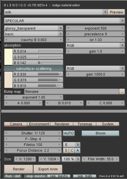

Here are the settings i'm using for milk.
My milk settings
Post by Kram1032 » Thu Mar 22, 2007 8:20 am
you should turn caaughy_b off, except you really need it!
It's SLOOOOOOOW
DaveC
Posts: 596
Post by DaveC » Thu Mar 22, 2007 8:21 am
Kram1032 wrote:you should turn caaughy_b off, except you really need it!
It's SLOOOOOOOW
Oops! That's left over from when my scene had water!! I modified it to get milk. lol!
Post by Kram1032 » Thu Mar 22, 2007 8:25 am
:P You should look at things like that
