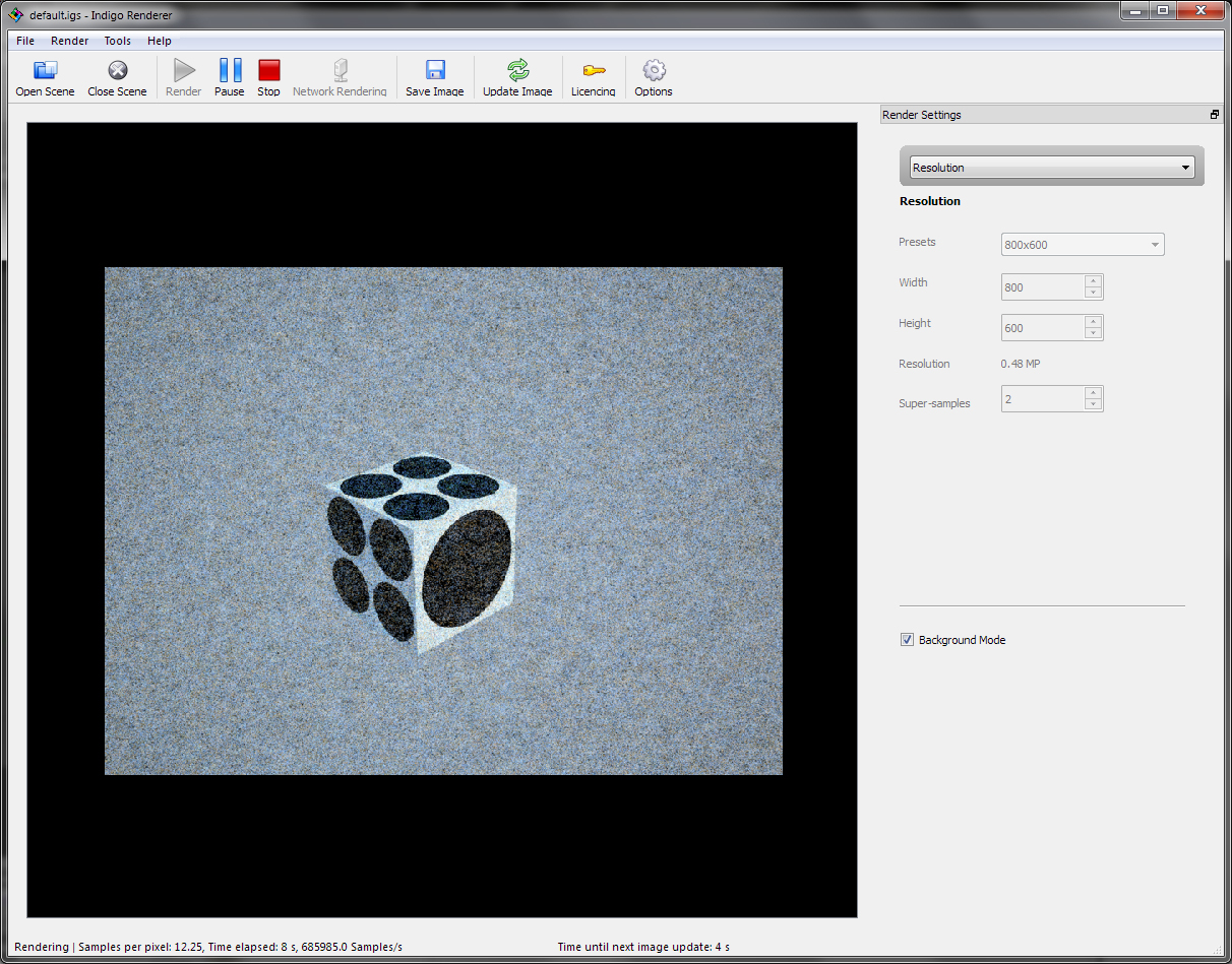

I'm not sure if this is a blendigo issue, but I'm trying to make a wheel, and have some weird issue with the bump map.
I've made a quick mesh from scratch with the same problem.
Blender 2.49a (same with b), blendigo 2.3.1, indigo 2.2.

The point was to show what happens to the rest of the mesh, not the displacement.
I'm talking about the weird pattern when using only the bump map.
Every face gets a circle on it when rendered.

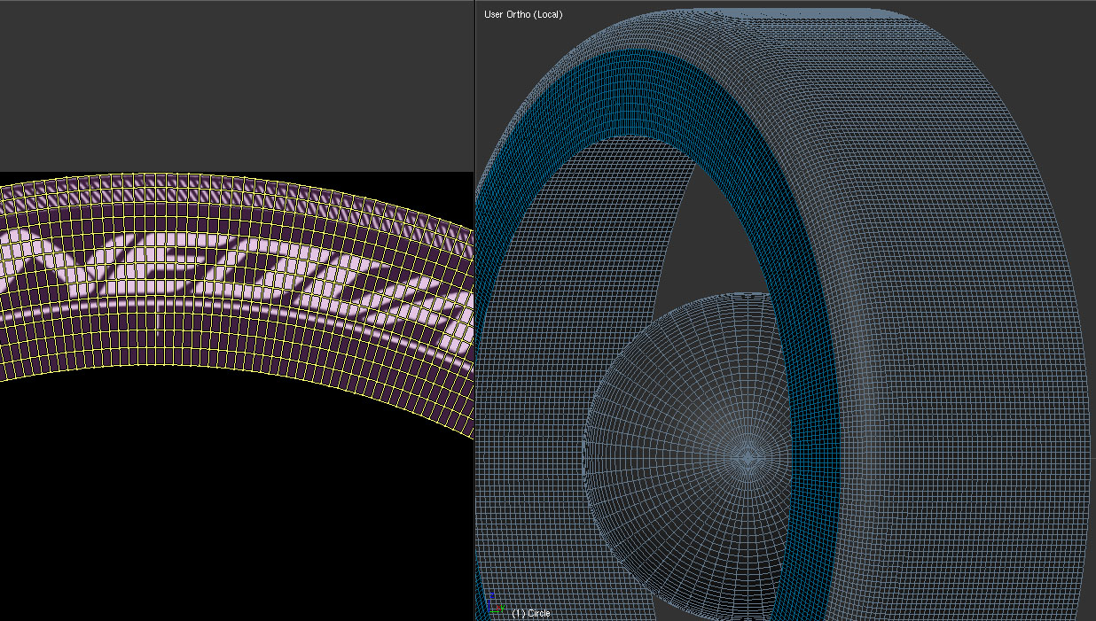

Wire with UV layout.
Bump at 2mm. Same sized circle pattern.
Displacement .006, corner smooth. Probably not enough faces for this texture, but should it affect faces outside UV layout?

I think blenders default uv-mappping is to have full image for each quad. As you haven't uv-mapped the rest of the tire, each quad has the whole circular bump-map you've made for the side.
You'll need to unwrap the whole tire to get rid of those circles.
