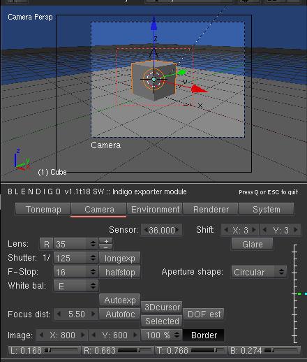

@dougal2 you can drive Blender from the script
I made both shift and crop work this way see attach.
I made it to auto align to the the camera view in the 3d window if 'border' or the shift 'x/y' were selected so you could see the extents.
shift actually has a limit of about 12mm for real 35mm lenses I found.
its a shame folks have had to wait 9 months or more for some of this stuff to get into commercial Blendigo ...hopefully you keep up with it a little better than @smartden did

Re: Blendigo 2.2.11-b
Hello again BigFan,
I've decided that if the controls are present in Blender, that they don't need to be replicated in Blendigo. Hence, users should just use border render and shift as they do in blender and it's automatically and transparently carried across to the indigo scene.
yeah I know just saying...its not so much hassle with changing Blender panels..and the crop is easier to adjust one direction at a time like this.. anyway..bye y'all
