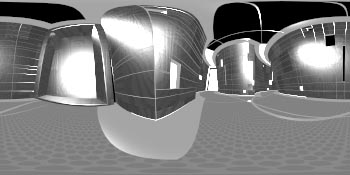

As to environment maps - they are just an easy way of getting realistic complicated lighting
Basically they are High Dynamic Range images of an environment normally 360 degree. For examples and some more info check out this forum thread that has links to some free ones and how to use them
http://www.indigorenderer.com/forum/vie ... f=7&t=2454
Indigo can only use .EXR ones but you can easily convert the ones there. For your diamond shot I would try this one
http://www.debevec.org/Probes/building_probe.hdr
To use an environment map again go to Blendigo and choose the Environment tab and select 'Environment Map' from the Environment Type drop-down. Then just point it to your .EXR file
I would also recommend that you set your tonemap to Reinhard initially as this will autoexpose your image for you.

No need to use any other lights with an environment map unless you want to for creative reasons.
Was it just the diamond that turned out black? like the examples below? if so maybe the normals on your diamond are flipped. The setup used here is just a plane with a white material and the diamond siting on it with the diamond material from the database and the following HDR used as the environment map. Nothing else. Hope this helps

Depends on your HDR environment image - does it have a lot of green in it?winnabago111 wrote:Oh ya, I completely forgot about normals. I flipped it and it worked the only issue is that the diamond has a green color and reflects green light. It still has a diamond look but its green tinted. My settings are reinhard Burn: 4.0200 PreS: 4.000 PostS:1.2
Could it have to do with Env. map. I have the gain at 1.0 and its on spherical with a width of 640. Thanks.
If it is a spherical one then Spherical is fine. If not then use LatLong.
Gain at 1.0 is the default and should be fine.
The green tint may also be because your scenes scale is too big? A diamond is usually only a few mm in size - is your Diamond scaled down that small?
Also leave it a while to render as it tends to render cleaner, purer after a time and most of the greeness goes away
