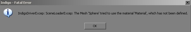

ookay...i downloaded grapejuice from mattDB and tried to use it on a simple sphere - no texture nedeed. i unpacked igm from pigm but error popped up -> see attachment . so do i have to edit matt name withim igm? and then it has to match matt name within blender??? its really painful when working with complex scenes...

Post by Borgleader » Sat Jul 12, 2008 5:06 am
you have to use the same name in the blender material as the one specified inside the .igm file (within the <name>...</name>)

Borgleader wrote:you have to use the same name in the blender material as the one specified inside the .igm file (within the <name>...</name>)
yepp...and thats the pain...
> @smarty? - can this be done automatically ? hope im not too annoying (if yes - forgive me pls!)
Post by Borgleader » Sat Jul 12, 2008 8:07 am
maybe a "get mat name" button could be added. but tbh just open it up in notepad...its not so hard. I have the igm set to open in notepad by default so i just double click...its easy really.
