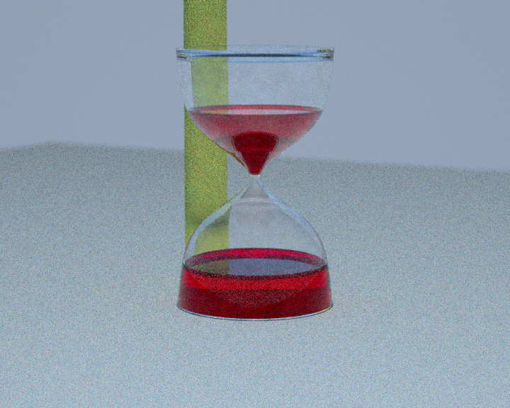

I'm just going to let it render overnight... Here is the beginning of the render...
Ari ;o)
Thanks a bunch, and Merry Christmas to you too.
Ari ;o)

I'm not sure I understand what I have to do with the precedence setting. In the render you see, precedence was set at 2 for glass and 100 for the liquid. What I think I understood is that I shouldn't distance the liquid's precedence from the glass's so much. So I've launched another with precedence for glass remaining 2, and precedence for the liquid being 3.
As to PT, Metropolis, Hybrid and the like, what do you think would be best for what I'm rendering? I've read somewhere (most likely in a tut or in the manual) that eventually they all converge toward the same "perfect" render, so does it really matter? Could you maybe point me to some place where they quickly go over the different options and their results? (or tell me quickly about it?)
I've added a couple of EdgeSplit modifiers, after marking some edges as Sharp. I didn't even know those existed, so thanks for the heads-up.
Still, something seems strangely off in that picture. The lighting, I guess, definitely, but I also think there's a problem with both meniscuses (if that word ever had a plural...) They're way too big compared to the hourglass itself, so they just show too much against the glass body.
Anything else that you think I'd have to fix?
Thanks for your help.
Ari ;o)
P.S.: Here's the second version rendering, with difference precedences and edge correction.
Ari ;o)

Regarding the precedence system. You have it back to front. It has nothing to do with how far one precedence is from the other. It's whichever is higher gets rendered. In your case, where the glass and the liquid cross over, the glass should have higher precedence so that it gets rendered. So you should set the liquid to less than the glass. Air has a precedence of 1. Everything else should be higher than air. So, set your liquid to 2, and your glass to 3. That should also sort out the meniscus problem.
regarding PT MTL or Hybrid: Everyone has his own philosophy, in that case...
You have an outdoor situation. Many would choose PT...
You have a complex Light situation with the glass and the liquid.. Here, Many would choose MTL...
Hybrid is a bit different... It is supposed to combine NTL and PT in their advantages. But it seems to be slower...
I dunno. Many choose it, not matter which sort of scene...
You need to test it for your own.
For now, use it, as is. When ever you like, you can test it
