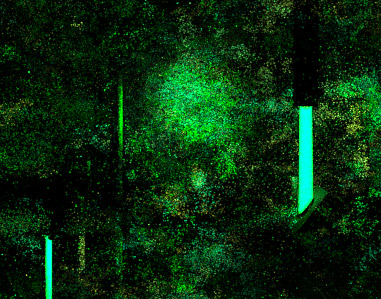

I'm testing some laser beams, too. The beam looks correct, but how can I create a mirror which reflects the beam 100%?
In this test the mirror is a phong material with exponent 1,000,000 and ior 1.0.
Or can I stop my tests - indigo can't archive this effect?

100% reflective mirror:
make a specular non-transparent material with 0 absorption and 100000+ IoR (ok, IoR100 is pretty much 100%, but higher is even better
I don't think, you have a laser, there, btw...
It's slightly cone-ish..
a laser should be straight, which can't really be done in Indigo...
If you don't already do so, try to use "peak" light with a very sharp peak

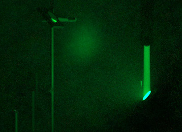

I have changed only the material. All other settings are the same. 25m rendering on 3 PCs. After such a time it should look better.
I'll try it with the phong and higher IOR.
EDIT: Yes! With a phong and IOR 100 I get a nice reflection. Thank you
Image after 6 minutes (I have changed only the mirror material):

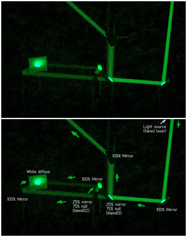

Hmm ... every specular material in the beam produces some problems. I have now a little bit complexer test. The light divider are blended materials (blend01, blend02) - mirror / null. I have used 75% null and 25 % mirror to get a 50% / 50% division. (visually)
I have no specular tests online!
This test needs some more tweeking. For a better performance the room has only three sides and the room has a black diffuse material to catch all free photons. Without an object behind the SSS athmosphere I get some other render problems. (no SSS will be rendered).
EDIT: I think the blend02 needs a second blend to some translucend material.

that's great!
strange that the specular doesn't work as needed...
humm...
I've one guess, why that could be:
are your mirrors solids or just flat meshes? (if they're flat, you really should make them solid... they can be very thin, but not flat)
for 50/50 transparency, it actually should be a 50:50 blend...
strange, if it isn't...
if you don't want to loose some light, up there, in the mirror that sends the beam to apparently nowhere, you should make it slightly larger
(though, it looks like a nice effect, so, there might not be a need for this
That new beam is far more straight
Do you think, you can straighten it out, even more?
I'm not sure, but I think, this is a scene, where it might be useful, to increase the maximum ray bounce depth (in the final render: before, it wouldn't make much sense, as it'll slow down the whole render)
while testing, you should lower it, though, just to get faster results
