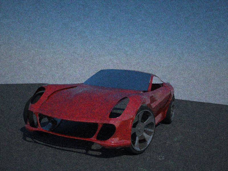

I have been posting this project i am working on, because I was looking for a good material to use for the paint. But I thought i would post a new topic seeing as how this question is about the glass...I cant seem to find the correct settings to get the glass in the windshield to look realistic..or transparent for that matter. I would appreciate any tips/tricks...thank you.
this is what it looks like right now...not transparent at all..and totally unrealistic...
Post by StompinTom » Tue Apr 17, 2007 12:33 pm
recalculate your normals outside. make sure the glass has thickness (not just a plane). use a transparent specular material with an ior of 1.5 or so, with no absorption.

I am still not getting any transparency...it is purely reflecting...it shows up transparent in the material preview.

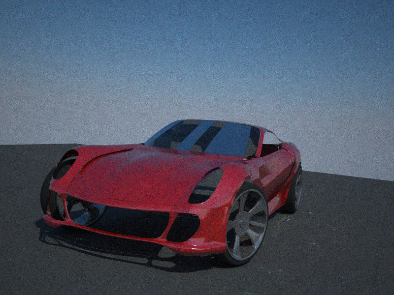

You need to close the mesh (in Edit mode, select all verts>W key>Remove Doubles) and then flip the normals to the outside (Ctrl+N).
Archiman86
Posts: 25
Joined: Wed Apr 11, 2007 7:10 am
Post by Archiman86 » Wed Apr 18, 2007 1:35 am
hey, THANKS ALOT! it works great now. I am glad I submitted my ego enough to post a question on here...I HAVE LEARNED ALOT!
