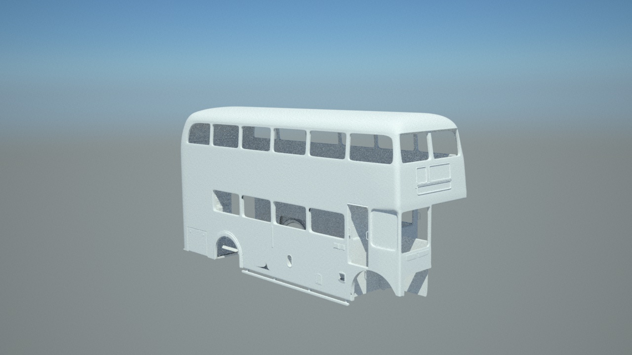

I am back on my workstation and I have finally selected a part of the project that shows the problem. The blend file still weights 100MB, compressed.
I have kept just the external hull of my recently modeled Routemaster double decker bus, and a sun lamp.

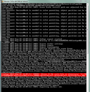

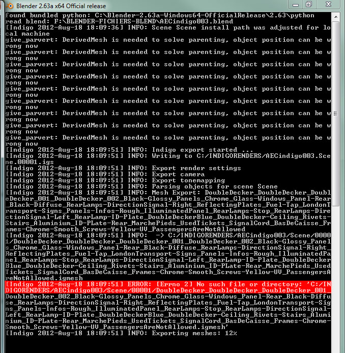

At export I get what you see on the screen shot of the console. I have set in red color the starting line of the error message. I had not set the texture image for some materials, but even after fixing that it is the same.

Wow.. that's quite a filename. It may be too long.ROUBAL wrote:@StompinTom

That looks like the object / mesh name. Can you check the object and mesh names in Blender for that object? Looks like there's a whole essay in there.

Well, it seems to be writing a whole lot more as a file name for some reason. If you look at the console screenshot you posted, it's not just the 2 red lines, it's also the 6 lines below those that are being included as the file name.

Ok. It seems as though Blendigo is doing a funny thing where it appends the material names to the object name when it exports. Since your bus has about 9 million materials assigned to it, it naturally makes for a file name that is way too long.
I'm a bit confused as to why Blendigo needs to do this, it seems like an unnecessary step and I don't recall it doing that before.
I would usually recommend you separate the model according the materials as a work-around, however in this case it wouldn't work seeing as all the bits are mostly integrated into one mesh.
Interesting issue, I've never had so many materials applied to a single object which is why I've never run into this.
EDIT: Just to clarify, the file name that is 8 lines long (in your above post where you highlighted the first 2 lines in red) contains the names of all the materials used by that model, which doesn't really make sense if the materials get exported separately anyway.
