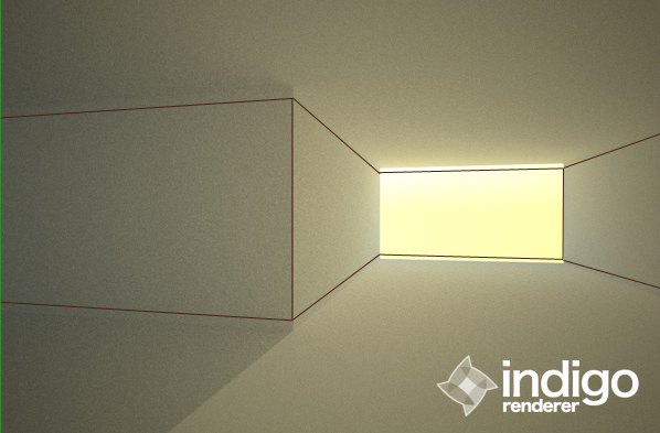

See attached image for example.
The overlaid lines shows how the Blender camera appears compared to Indigo. Pretty much a showstopper :(

Looks like the blender camera needs an overhaul as it's not matching real world optics.
Try using lens degrees instead of length, since that seems more correct, but that would probably not work either.

Indigo is 100% correct according to http://www.tawbaware.com/maxlyons/calc.htm
Blender is funky.

What Indigo prints out in the GUI (in the focal length spinbox) is not actually the focal length, but the lens-sensor distance. The two are equal only when the focus distance is set to infinity.
