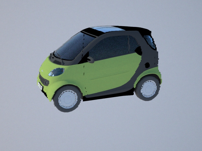

No SSS, just diffuse materials with sunlight (no background)

I've had similar results when rendering a structure on a large terrain model. Once I remove the terrain mesh, the problem goes away. Now I haven't tested to see whether it is the texture I've applied to the terrain mesh or the mesh itself, but I assume it may be either one of those things causing the problem.
edit:
Well i did some more experimenting with removing all the textures from the large mesh (~17,000 polygons) and still got the strange artifacts in the rendering. Then I went ahead and removed the mesh all together but it was still producing the same effect. So now I don't know what could be wrong, I guess my file is goofed some how, or maybe my modeling software! (SU 6) Dunno.
