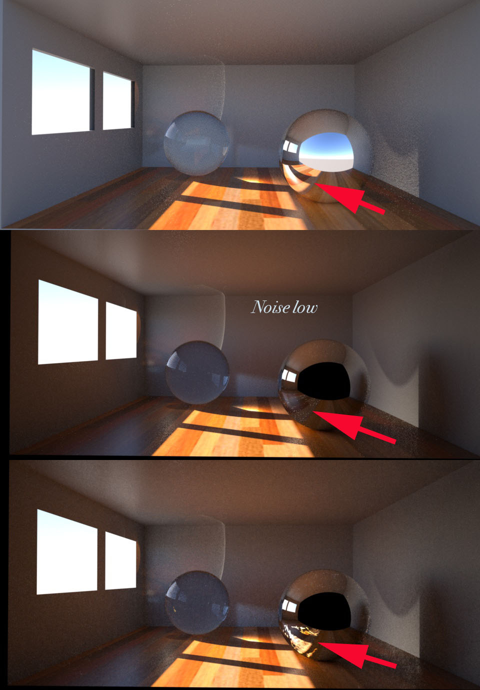

Three experiments with Exit Portals in SketchUp 2015 Mac Edition.
1) Without Exit portals, on the sphere are projected reflected the two openings on the floor. Bidirectional Path. SS=3
2) With Extit Portals, the ball does not reflect the two openings projected on the floor. Bidirectional Path. SS=3
3) With Extit Portals, they reflected badly on the sphere and two openings projected on the floor. Bidirectional Path / Metropolis. SS=3
I am a bit 'confused ....

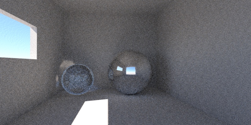

How many exit portals do you have? Only on windows?contegufo wrote:Three experiments with Exit Portals in SketchUp.

i've done a quick test and it behaves as expected

But the bright areas on the floor are not reflected in the ball...pixie wrote:i've done a quick test and it behaves as expected
Re: Experiments with Exit Portals.
It is!bubs wrote:But the bright areas on the floor are not reflected in the ball...pixie wrote:i've done a quick test and it behaves as expectedSurely this is not 'expected' behaviour...
The few fireflies you see in the Sphere ARE the reflections, render that scene over night and you'll see that this noise ends up as the missed reflection!
This issue here is exactly the reason why EPs need some rework, while EPs speed up flat light like from the sky a lot, they slow down such second bounces of small lightsources like the sun or other small stuff like lamps in a HDRI!
See here: http://www.indigorenderer.com/forum/vie ... =7&t=13645
Please redo your scene by closing the wall behind the camera or putting another EP there contegufo.
Also try putting some simple windows (using Arch Glass) on the openings, so you'll have a even more complex scene that is closer to real work usage

you're right! haven't noticed, i was focused on the fact that the background went blackbubs wrote:But the bright areas on the floor are not reflected in the ball...pixie wrote:i've done a quick test and it behaves as expectedSurely this is not 'expected' behaviour...

Zom-B: I still think a few fireflies instead of highlights isn't really "expected behaviour".
Oh sorry, I simply forgot to explain that this light paths are so hard to hit without MLT or Photon Mapping, that it sadly is like that... expected :/Oscar J wrote:Zom-B: I still think a few fireflies instead of highlights isn't really "expected behaviour".
Expected because of the known limitations of the actual Exit Portal Model.
