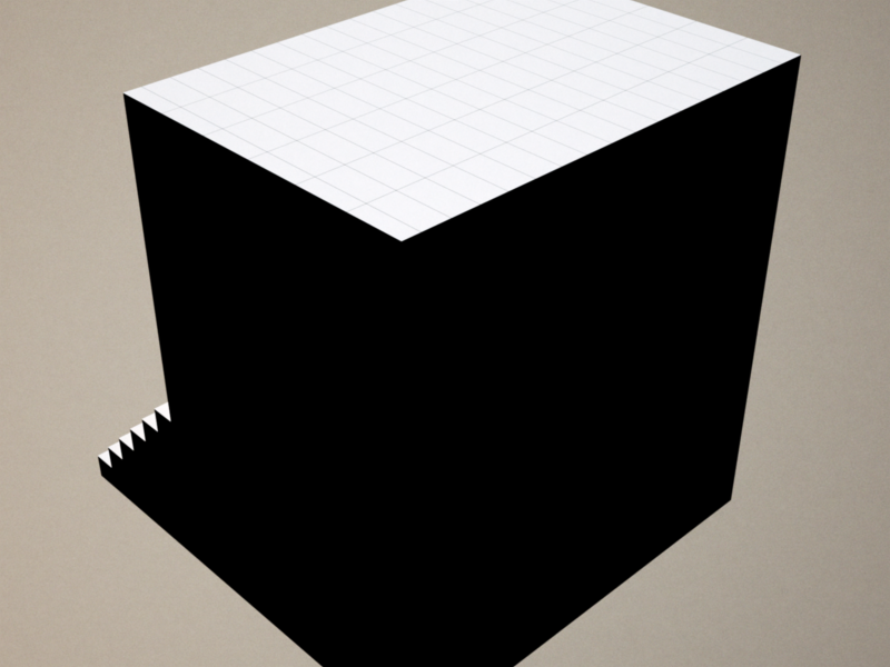

progress ... kind of? the grid is showing up but not exactly how i'd planned.
the grid
Post by Kram1032 » Tue Sep 23, 2008 7:20 am
how did you plan it?

cpfresh wrote:progress ... kind of? the grid is showing up but not exactly how i'd planned.
might not be as planned, but really cool looking nonetheless!
cpfresh
Posts: 501
Location: California, USA
Post by cpfresh » Tue Sep 23, 2008 8:28 am
lol thanks crojack. :)
mark: the plan was a black grid on white but i think it's safe to say that i've got the colors quite mixed-up.
back to the drawing board?
Post by Kram1032 » Tue Sep 23, 2008 8:35 am
just to the colour-part of the drawing board ;)
Well, Just as crojack, I like it as is ^^
If you change it a bit to be yellow everywhere, it could be the perfect Holoroom^^

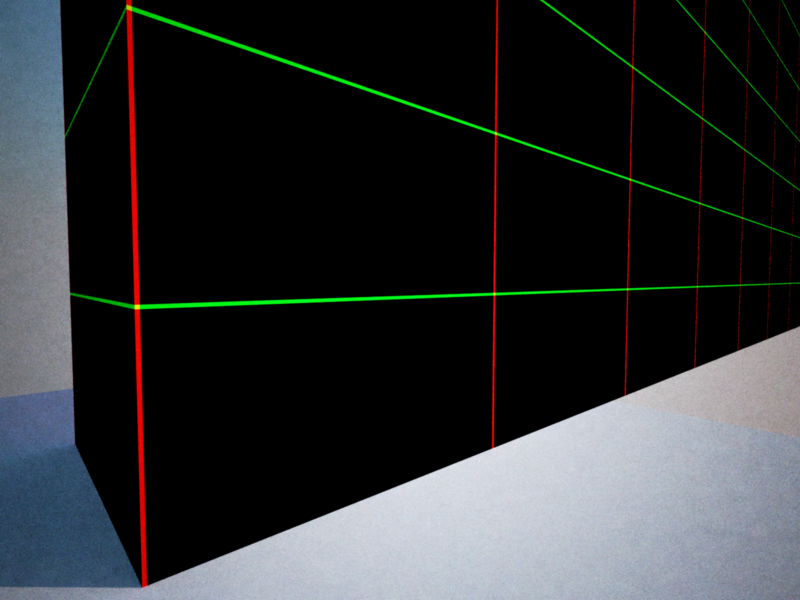

Post by cpfresh » Tue Sep 23, 2008 10:26 am
crojack:
i forgot to mention you'll need to add another set of <shader> and </shader for the checkboard to work. sorry.
as far as further progress goes, ... peep the grid:
the other side ... not so much
cool on one side

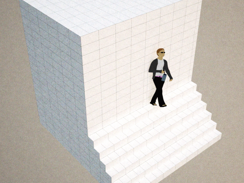

Post by cpfresh » Tue Sep 23, 2008 7:05 pm
ok well i think im stuck on this shader as i cant seem to get the courses to alternate the offset. my code is below. the problem lies in not being able to use the odd() function as given by Ono. i'm using reals and the function wants ints. i tried a work around for this but never-the-less it remains in grid form and not a CMU pattern as i'd hoped. any comments or solutions are welcome. thanks
            <albedo>
                <shader>
                    <shader>
                        <![CDATA[
                        def eval(vec3 pos) vec3 :
                        vec3(
                             # this first if is to determine whether
                             # this is an odd or even course
                            if(
                                eq(
                                    mod(
                                        sub(
                                            div(
                                                dotj(
                                                    getTexCoords(0)
                                                ),64.0
                                            mod(
                                                dotj(
                                                    getTexCoords(0)
                                                ),64.0
                                         ),2.0
                                    ),0.0
                                #this is one course configuration
                                if(
                                    and(
                                        gte(
                                            mod(
                                                doti(
                                                    getTexCoords(0)
                                                ),128.0
                                            div(
                                                125.0,128.0
                                        gte(
                                            mod(
                                                dotj(
                                                    getTexCoords(0)
                                                ),64.0
                                            div(
                                                61.0,64.0
                                    ),1.0,0.0
                                # this is the other course configuration
                                if(
                                    and(
                                        gte(
                                            mod(
                                                add(
                                                    doti(
                                                        getTexCoords(0)
                                                    ),64.0
                                                ),128.0
                                            div(
                                                125.0,128.0
                                        gte(
                                            mod(
                                                dotj(
                                                    getTexCoords(0)
                                                ),64.0
                                            div(
                                                61.0,63.0
                                    ),1.0,0.0
                    </shader>
               </shader>
i've used the 64 (8x8) and 128 (16x8) as the dimensions of my cmu blocks -- broken down into 1/8ths of an inch. i did this so the lines would be the width of the mortar joint (3/8")
Post by Kram1032 » Wed Sep 24, 2008 1:30 am
Sorry, meant "holodeck" I didn't know, it's "deck" in english, too, so I hoped I'd hit the word with "room"^^
http://en.wikipedia.org/wiki/Holodeck
to get ints from reals, use floor(real+0,5) ;) (or alternatively, ceil(real-0,5))
I wish I could see this with simple calc-signs.... As it is here, it looks pretty confusing, somehow....
