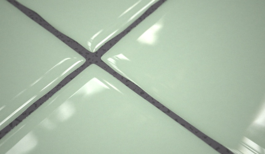

Re: Variables or registers in ISL
Here is a closeup (width of dark zones : ~3mm) and displacement mapping.
I'm not fully happy with the specular reflection on the rounded edges, as there should be no sharp edge between the round part and the flat top. Maybe something is wrong in the subdivisions/displacement/smoothing
Etienne
Etienne
