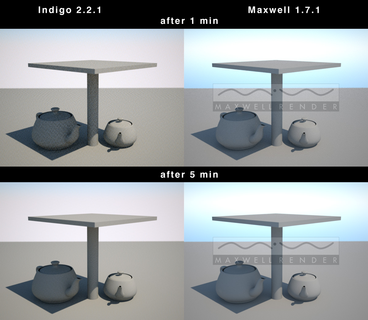

Post by suvakas » Sat Aug 22, 2009 6:31 am
I was curious and I made a similar scene.
Here's the result:
Indigo vs Maxwell - Sun-sky scene
Same sun and same camera parameters.
Seems like Maxwell cleans faster in sun/sky situation...
