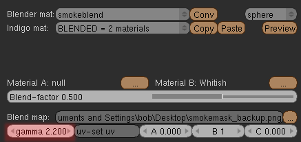

I figured it out, i'm elated. :D i increased the gamma setting for the blend map, simple as that. as u can see it looks much better now, i thought i'd post the results incase anyone else has this problem
new result
setting i changed to fix the problem
Post by Kram1032 » Wed Feb 13, 2008 11:02 am
oh, interesting...
actually, that gamma should be at 1 for such a map, but seemingly, 2.2 is the default, even for such a kind of a map...

i think i know what caused the strange behavior. indigo expects a color blend map, so when i feed it a RGB image with grey values, it adds red green and blue together. so if thats the case, the proper way to fix it, is to set gamma to 3, instead of 2.2
Post by Kram1032 » Fri Feb 15, 2008 11:32 am
no, I actually thought about it:
2.2 is fine, except using a mac-screen, where you need 1.8.
It's because the blend only looks smooth at 2.2. 'cause your screen looks like that.
at 1, it wouldn't.
(simply make a standard smooth gradient and then set it's gamma to 0.454545454545454545..... (doesn't need that accuracy^^), to see, what Indigo saw :) )
