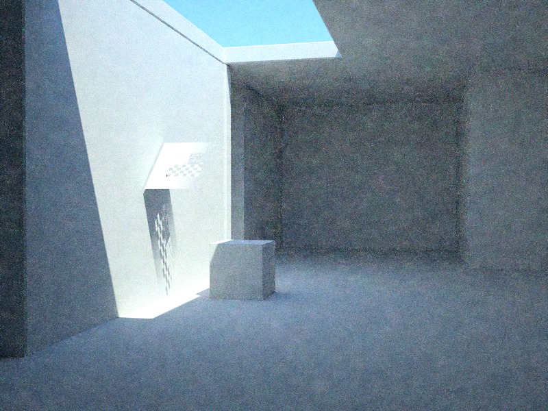

Hi,
I'm testing the way to use "alpha maps".
I have blended a white diffuse material with a null material.
The shadow looks good, but the null material is rendered as a gray material.
the code:

Diffuse blended to null material
Post by CTZn » Mon Nov 19, 2007 3:39 am
That may be because bidir is on, AFAIK null material doesn't like that.
Post by OnoSendai » Mon Nov 19, 2007 3:43 am
Looks alright to me, where's the problem?

Post by Conz » Mon Nov 19, 2007 3:49 am
OnoSendai wrote:Looks alright to me, where's the problem?
EDIT: Null material is not transparent with bidir on. Try your grass tutorial with bidir on.
CTZn was right. The problem was the bidir. (Thanks for your help)
I have rendered it now with Metropolis only and it's looks ok.

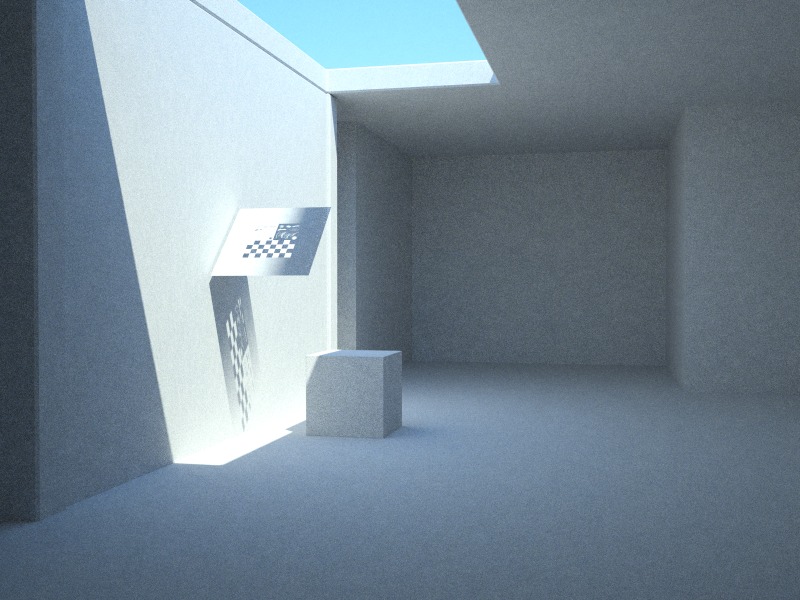

Here's the Metropolis render:
Metropolis don't have the problem.

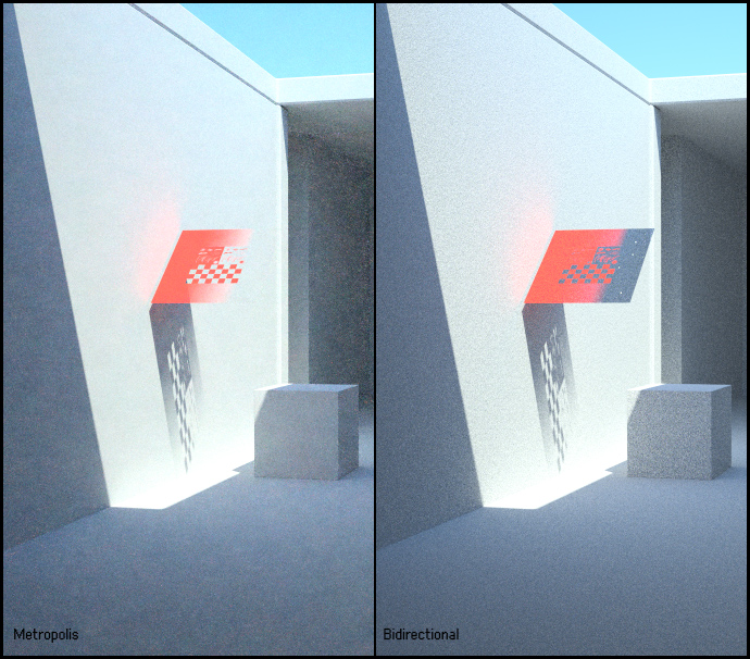

Some clear rendering. The diffuse material is now red.
Post by CTZn » Mon Nov 19, 2007 6:26 am
I spent some time myself checking the image b4 posting, but I did when I identified that the gray region on plane could not be a shadow projection.
That's a known issue Conz,
cheers !

Yes I agree, the first sample picture was not clear enought.
