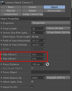

Hi, try in C4D - camera - object - film offset x, y. In indigo - camera - shift up, right...

thanks, i'm gonna try but i assume it only shifts the frame of the camera, there's no tilt (different angle of the lens and the sensor)?

I always thought of tilt/shift as being the same. What Cinema calls "film offset", indigo calls shift up/right and theplugin takes care automatically.
