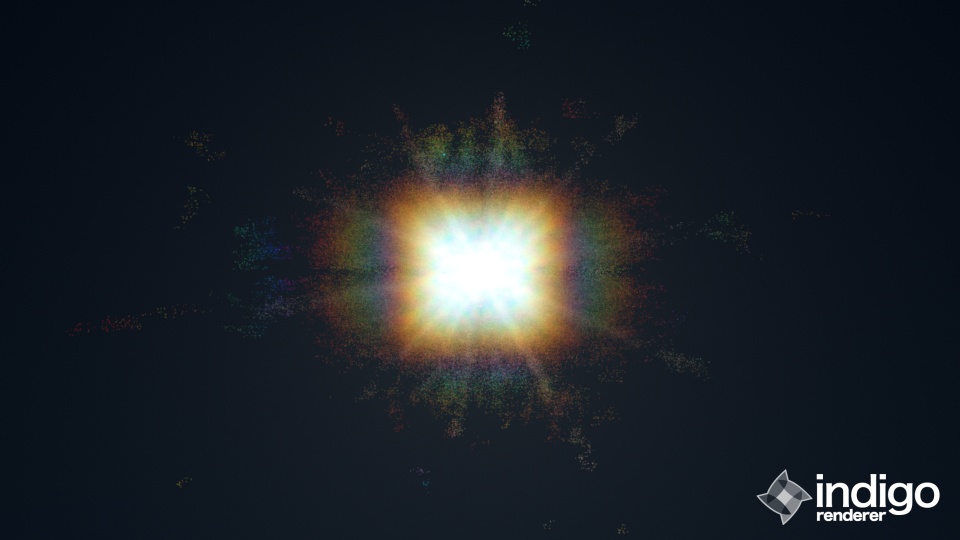

Can anybody tell me how to use aperture diffraction to get some nice lense flares? Does not work for me...

already tried path tracing with MLT, and I have tried every obstacle map I can get.. But I never get it like in the manual, see below. There must be another option...

maybe this is a problem with Indigo v4?
Works fine in v3...

i thought it was mentioned somewhere that it doesn't work in 4.0.54... oh, i think this is it:
... because in the last one the obstacle map is broken...
post by yonosoy

Ah, ok. Thank you for this information. So it's a bug...
