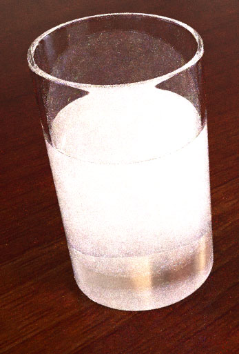

I'm trying to render a glass of milk since it seems like these are kind of in nowadays. :D
I would like to achieve a result like this:
http://www2.indigorenderer.com/joomla/f ... light=milk
But I have some problems: I followed the modeling instructions for fluid in a glass from here:
http://www2.indigorenderer.com/joomla/f ... .php?t=637
And I used the milk material from here:
http://www2.indigorenderer.com/joomla/f ... 88eb0#9018
The glass material I use is this:
	<medium>
		<name>GlassMedium</name>
		<precedence>10</precedence>
		<basic>
			<ior>1.50</ior>
			<cauchy_b_coeff>0.0</cauchy_b_coeff>
			<absorption_coefficient_spectrum>
				<rgb>
					<rgb>0.5 0.5 0.5</rgb>
				</rgb>
			</absorption_coefficient_spectrum>
		</basic>
	</medium>
	<material>
		<name>GlassMaterial</name>
		<specular>
			<transparent>true</transparent>
			<internal_medium_name>GlassMedium</internal_medium_name>
		</specular>
	</material>
My problem is this: The bottom of the glass looks way too white which is very unrealistic. Also the milk is just too white...
But have a look yourself:
milk and bottom of glass way too white.
Glass model I used.

Post by OnoSendai » Mon Mar 12, 2007 6:26 pm
Make sure the precedence of the glass medium is higher than that of the milk medium.

Post by OnoSendai » Mon Mar 12, 2007 9:27 pm
heh, no, when i say higher, i mean a higher value.
Yes, i know this contradicts the CS convention, but meh.

Post by OnoSendai » Mon Mar 12, 2007 9:34 pm
absorption 0.5 0.5 0.5 is very slight absorption (mean path length on the order of 2m)

Post by OnoSendai » Mon Mar 12, 2007 9:50 pm
The units changed from Indigo 0.6 to 0.7.
The units of absorption changed from mm^-1 to m^-1
