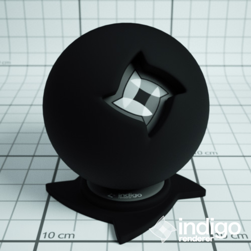

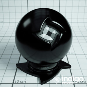

that has been my understanding. though it probably depends on gamma setting of the texture somewhat too. but this could probably be confirmed using a nice solid black and white checker texture and comparing to normal phong exp values set in the B and C slots
edit:
yeah, just confirmed this, see attached. regular phong with exp 1 and 1000, respectively, and then using a 100% black, 100% white checker texture for exponent with C value 1 and B value 1000.
exponent 1
exponent 1000
exponent map with C value 1 and B value 1000
