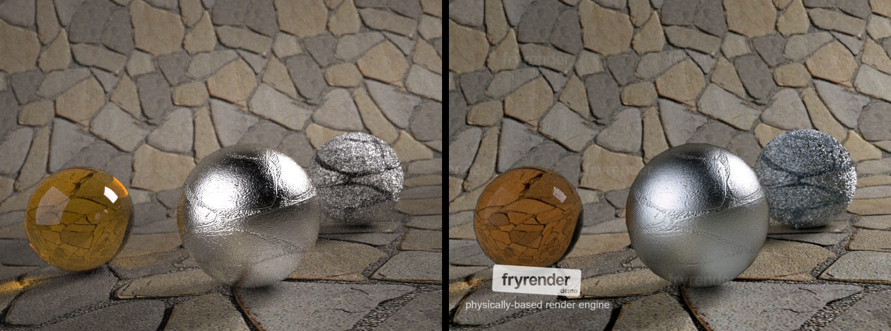

To me too.oogsnoepje wrote:The Fry-version looks like a trip to the north pole with water flying in the air.
Indigo looks more like under water to me

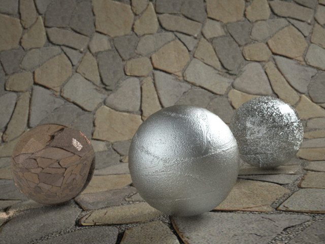

here is another comparison - Camox's studio setup tweaked with another person's spheres
Fry rendered for 1hour, and Indigo 50mins. Allowed an extra 10 for Fry's use of Micro poly Displacement. Used Bidirectional MLT in Indigo, and it rendered pretty quickly with 100,000 ray bounces to boot
I have attached the original Fry render which is supposed to be at 6500 white balance, but it sure don't look it!
I had tweak it in Fry's tone mapper - removed 10 units of green and blue, and added 10 units of red, then added some slight contrast boost.
The caustics and reflections in Fry took forever to show in the main render, I could see them in the small preview image, but not in the main image until 30mins in. Indigo already had them within 3 mins and the caustic refractions as well!!
Don't think the caustic Refractions are ever gonna show in Fry.....
Used the Aluminum preset in Fry for the other spheres, and the Aluminum (al.nk) NK file in Indigo.
Bumpmap from the tile bump map image - which worked really well in Indigo. Just a slight -0.002 setting for the front sphere and a -0.02 setting for the rear sphere to emulate the Micro poly displacement of Fry. Used negative values as Cindigo's exported meshes are somehow reversed...
And bump map values were hand edited in, as there is a bug in Cindigo that won't register changes in bumpmap into the scene file.
I take back what I said about Indigo's bum map, it looks good!
Matches well with Fry, but the Fry's right sphere is actually larger from the micro poly displacement of 15cm.
MPD in Fry rocks! It's slow to warmup when previewing materials, but when actually rendering I didn't notice much if any warmup time increase and the render didn't seem much slower or more memory hungry!
Will Indigo get MPD as good as Fry's one day..?
You can see this dark edge on the Fry's spheres. I think it lacks energy compensation or something that Indigo has
I also attached a 15min render of the Maxwell version just for a quick comparo. I'm not a fan of the washed out Maxwell look. What the hell is going on with the bumpmap on the right sphere....? And the white reflection overriding the bump map?
At least the reflections and caustics are there

cool test
Indigo and Fry look pretty similar, besides the lack of caustics in Fry and the MPDsphere on the right
- where the stone-plates should be higher, on the floor, you clearly can see the difference between bump and MPD...
I think, you should have used more polys for the spheres - they're quite edgy...

I need to try more MPD in Fry!
It is probbaly the best MPD I have used in any renderer, quick and memory light!
Fry really needs NK support and a simple Phong model, and better refractions and glass...
and faster indoor rendering - ironic that it developed exit portals to speed up interiors, but is in itself much slower than Indigo who nabbed it's exit portals
oh and fix the tonemapping and white balance....
