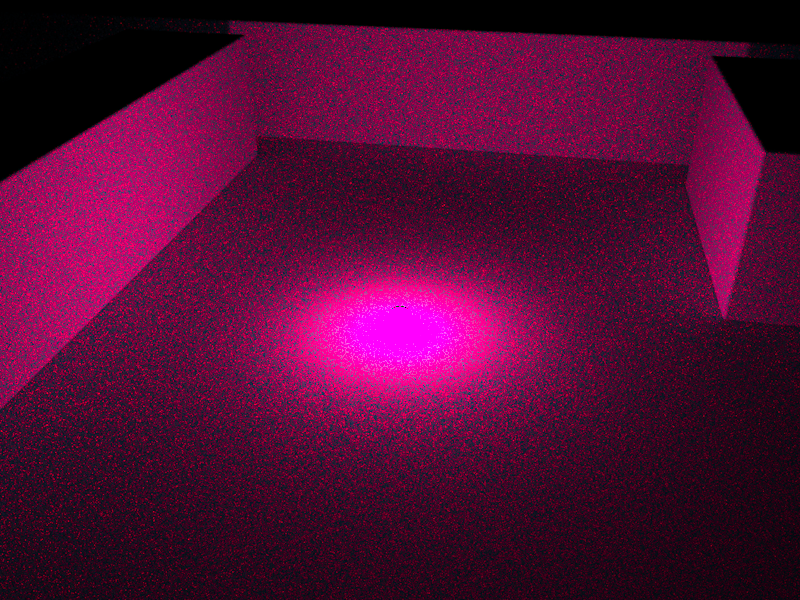

Re: Reqiest║Metal temperature
Post by fused » Thu Dec 17, 2009 1:10 pm
    <material>
        <name>0_mid0</name>
        <phong>
            <ior>1.010000</ior>
            <diffuse_albedo>
                <constant>
                    <rgb>
                        <rgb>0.800000 0.800000 0.800000</rgb>
                        <gamma>2.200000</gamma>
                    </rgb>
                </constant>
            </diffuse_albedo>
            <exponent>
                <constant>1000.000000</constant>
            </exponent>
            <base_emission>
                <constant>
                    <regular_tabulated>
                        <start_wavelength>0.34E-06</start_wavelength>
                        <end_wavelength>0.75E-06</end_wavelength>
                        <num_values>64</num_values>
                        <values>0.0359 0.0784 0.0134 0.0258 1000000.0359 0.0784 0.0134 0.0258 0.0359 0.0784 0.0134 0.0258 0.0359 0.0784 0.0134 0.0784 0.0134 0.0258 0.0359 0.0258 0.0359 0.0784 0.0134 0.0258 0.0359 0.0784 0.0134 0.0258 0.0359 0.0784 0.0134 0.0258 0.0359 0.0784 0.0134 0.0258 0.0359 0.0784 0.0134 0.0258 0.0359 0.0784 0.0134 0.0258 0.0359 0.0784 0.0134 0.0784 0.0134 0.0258 0.0359 0.0258 0.0359 0.0784 0.0134 0.0258 5000.0359 0.0784 0.0134 0.0258 0.0359 0.0784 0.0134 0.0258 </values>
                    </regular_tabulated>
                </constant>
            </base_emission>
            <layer>0</layer>
        </phong>
    </material>
4 minutes
Post by lycium » Thu Dec 17, 2009 1:25 pm
pretty much what i expected :) and it's easy enough to account for (just say "spectral MIS" to nick), but not worth it since such extreme cases are kinda rare. well, there's flourescent lighting that's quite common and very peaky (hence undesirable)...
