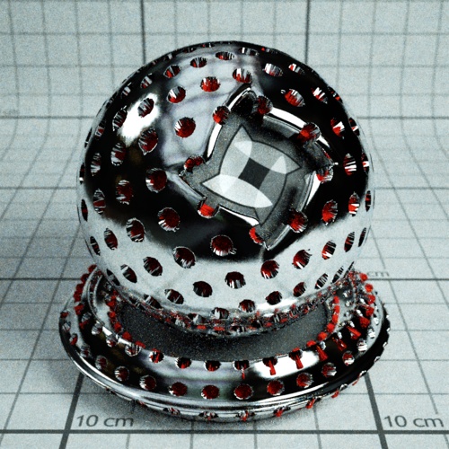

4) Remove or fix the bubbles (only mildly useful for about 5% of all materials, plus, they can ruin a displaced material preview). The SSS bar should fulfill the purpose of the bubbles. It could be that the bubbles are just modelled wrong. IMO, they should be modelled using an 'air' material with precedence of 2. I think they are actually modelled as part of the preview sphere mesh (and material) which is wrong.

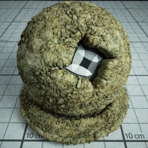

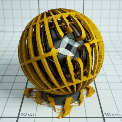

No displacement in the base. I hand-edited the scene to improve the displacement

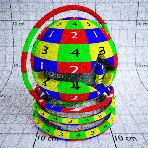

This is the scene I'm using for internal material testing, let me know what you think 8)

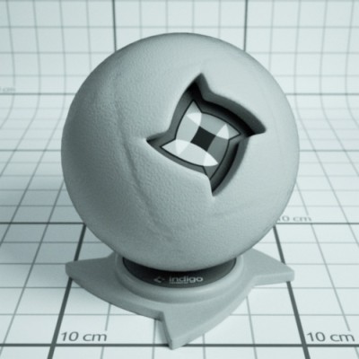

Well, I guess no one has the time to fix this scene so I'll take a crack at it. It gives me a chance to improve my Blender skills at least. 8)

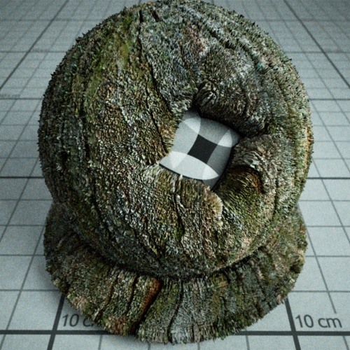

These are two renders of the exact same material. Here's what I've changed so far:
- removed bubbles
- reset the transformations of the meshes so the displacement and bump is the correct scale
- lowered the 'b' value of the ground texture so it's not so white and washed out
- changed the subdivisions settings so it is actually useful for displaced materials
I really want to change the base of the preview scene. The mesh is really bad for displacement and the UV mapping is bad (mainly due to the bad mesh)
I thought it would be cool to use the Indigo logo shape and revolve it around the up axis of the scene (kind of like the 'L' shape in the Maxwell preview. I'll post it later if I can pull it off.

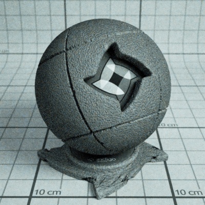

using modified preview scene.
using Indigo Material Editor preview scene

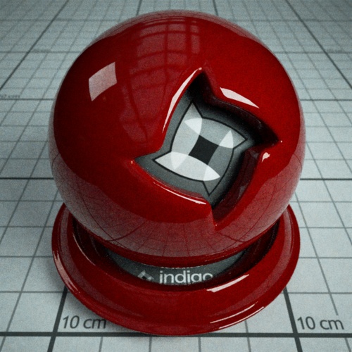

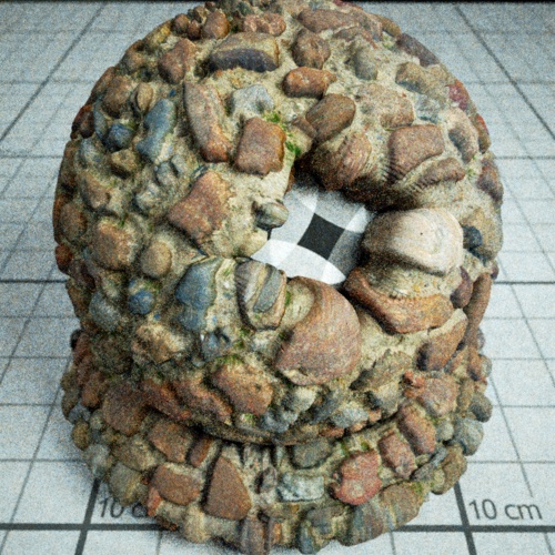

Some tests with the new base. I beat my head against the wall trying to UV map the base in Blender. But in the end, it came out ok. Comments?
red plastic.jpg (109.71 KiB) Viewed 6271 times
Whaat
Posts: 1827
Location: Canada
Re: [Req] Fix and Improve the Indigo Material Preview Scene
Post by Whaat » Thu Nov 26, 2009 6:46 am
One thing that always bothered me about the Indigo preview scene was that the preview object seemed a bit too 'distant'. In the Maxwell scene, I always felt like I could reach out and touch the material.
When I examined the Indigo scene, I noted that the focal length of the lens was set to 50mm so I made it a wider angle and moved the camera closer.
Comments?

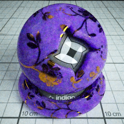

Post by Whaat » Thu Nov 26, 2009 8:28 am
More tests: :)
Post by pixie » Thu Nov 26, 2009 8:37 am
Whaat wrote:One thing that always bothered me about the Indigo preview scene was that the preview object seemed a bit too 'distant'. In the Maxwell scene, I always felt like I could reach out and touch the material.
Comments?
You've bump onto something here, they become much more vivid! Me like those much more!
