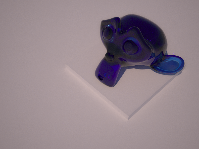

I just downloaded Indigo and am struggling to use it. So far I have been unsuccessful. Here are two of my attempts. The monkey was rendered in Blender and Indigo, and the vase was rendered in Yafray and Indigo.
Both the pictures assign a black, non reflective material to things I don't want. Why is this?

Monkey Render.png (444.88 KiB) Viewed 4163 times

Hi !
Which version of Indigo and which exporter did you use ?
And what kind of lighting did you set ?

Post by Vendetta » Sat Mar 24, 2007 4:09 am
I'm using Indigo 0.6. I downloaded it from the Stable Releases page. I set up one sun lamp, 15 degrees left of the camera, pointed at the subjects. I used the v0.6beta3 exporter.
Post by Kram1032 » Sat Mar 24, 2007 5:57 am
This looks really strange...
Now, the new indigo version (atm 0.7.5 soonish 0.7.6)
is already easier to use, than 0.6, 'cause of the better exporters...
try 0.7.5 ;) It's quite stable, I never had a problem with it, yet (except 'cause of my fault) and blendigo is really helpful :D
Did you use thick materials? (especially the vase)
and did you use phong, or specular?
I recomend you, to use phong, as both the vase and suzanne don't seem to be transparent in the other two renders ;)
(you can set it up, by don't using Raymirrior or Raytrans, but quite a high Specularity ;)
