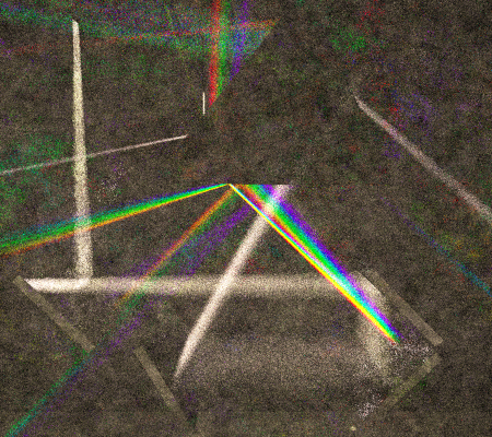

You need to set the prism to have a higher precedence than your media, for example media precedence =10, prism precedence =15, also you might want to turn down your cauchy coefficient to something like 0.013, as your value of 0.5 is very unrealistic and probably a bit extreme for the precise reflections you need :D
I think thats it, you probably need to adjust the position of the prism a bit but it looks as if it will be ok...!
Funnily enough i made a similar scene yesterday morning and had exactly the same problem :P, but mine is not quite as inventive as yours hehe! heres what yours looks like after i made the changes above, couldnt let it render for too long as ive got another render cooking atm (the prism below).
Good luck man!
Participating media after a couple of minutes, evidence of some tasty dispersion...!
Funky colours!.jpg (365.6 KiB) Viewed 5046 times
My somewhat less inventive experiment after 2 hours or so
my prism.jpg (224 KiB) Viewed 5046 times

Post by sprocket » Sat Apr 14, 2007 4:46 am
Basically, if two different objects with a specular/medium material occupy the same space, indigo considers the object with the higher precedence to be the one occupying the space.
eg a small sphere of liquid inside a large glass sphere requires the liquid to have a higher precedence or indigo will just assume that the whole volume is made of glass and ignore the liquid :?
erm yeah :D precedence control is in the specular mat in blendigo, its underneath the 'tranparent' button.
hope that helps! :)

Post by sprocket » Sun Apr 15, 2007 8:40 am
OnoSendai wrote:Woo dispersive participating media caustics!!!
Better than DOF? :lol:
@ suvakas: Basically just model the same way as for the normal prism that Ono posted waaaay back. You need prism with the correct ior and dispersion, and a light shining down a loooong hollow cuboid to try and simulate a sort of parallel light beam effect through a rectangular slit. Pop the whole scene inside a cube with a fairly low sss material to get visible light beams. In my scene I also put it all in a 'room' with very dark diffuse walls, dunno if it helped but it seemed to speed things up! Hope thats what you were after :D
