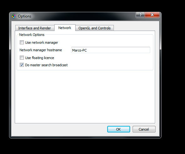

1. i call my master (64bit W7 with quadro 4000) with a name and i set in indigo the name of the pc (look the attachment)
2. i install indigo in every pc of the network and i set in option menu the same name of the master
