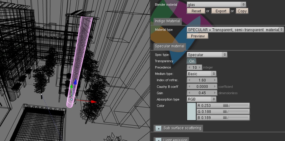

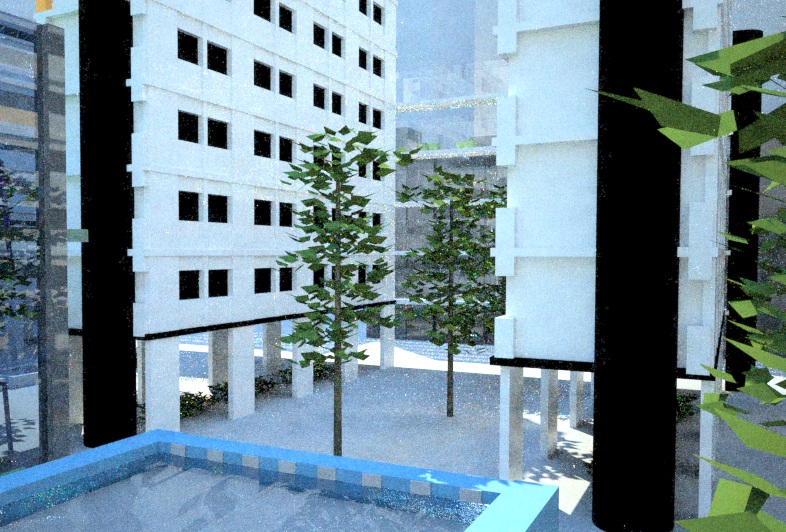

nothing went wrong with this material when previewing, but when i started rendering with the whole scene...
i m new to indigo 2.4, this never happens in 2.2

Which version of Blendigo is that ?
Re: the glass material become black in indigo 2.4.13
Post by Borgleader » Wed Dec 15, 2010 2:23 am
a) Are the cylinders closed volumes? From this angle I cant see if the end caps are present
b) Did you check that your normals are correct?
Post by CTZn » Wed Dec 15, 2010 4:43 am
I second borgleader.
Absorbtion may be too strong.
It is not good to interrsect glass and other materials. You must change the column or the walls (boolean difference plus a distance between surfaces).

dougal2 wrote:Which version of Blendigo is that ?
blendigo 2.4 stable. maybe i should rebuild this material in 2.4, instead of moving it to 2.4 from 2.2

Post by chiataimakro » Wed Dec 15, 2010 5:00 pm
Borgleader wrote:a) Are the cylinders closed volumes? From this angle I cant see if the end caps are present
thankyou but i m quite sure there's nothing wrong in modeling: it does have caps and, all face normals are correct. this model works quite well with indigo 2.2

Post by chiataimakro » Thu Dec 16, 2010 1:24 am
i replaced the glass material with a diffuse one. it's still black.
it's a shame that i have to switch the whole project back to indigo 2.2. at least in 2.2 everyting works.
btw why shouldnt i intersect glass meshes with other meshes, that i always do?

Post by chiataimakro » Sun Dec 19, 2010 2:36 pm
well yes the IGS from 2.2 behave abnormally in 2.4.13
i tried the 2.4 exporter, the same result
now i m gonna try 2.6. good luck to myself. and everyone here are very kind thankyou!
