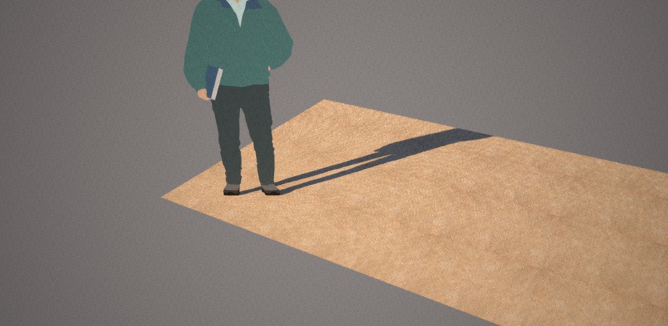

I haven't done it for a while, so thought I would run through my tutorial to refresh my memory and it doesn't work. I've followed every step exactly, but I'm getting odd results. What am I doing wrong?
Setting up my mesh using the exact settings on the link above, changing the UV mapping in the material editor: Displacement stays flat but simply moves the entire plane up. Why?: Bump map adds curious artifacts. Why?: What on earth am I getting wrong here?

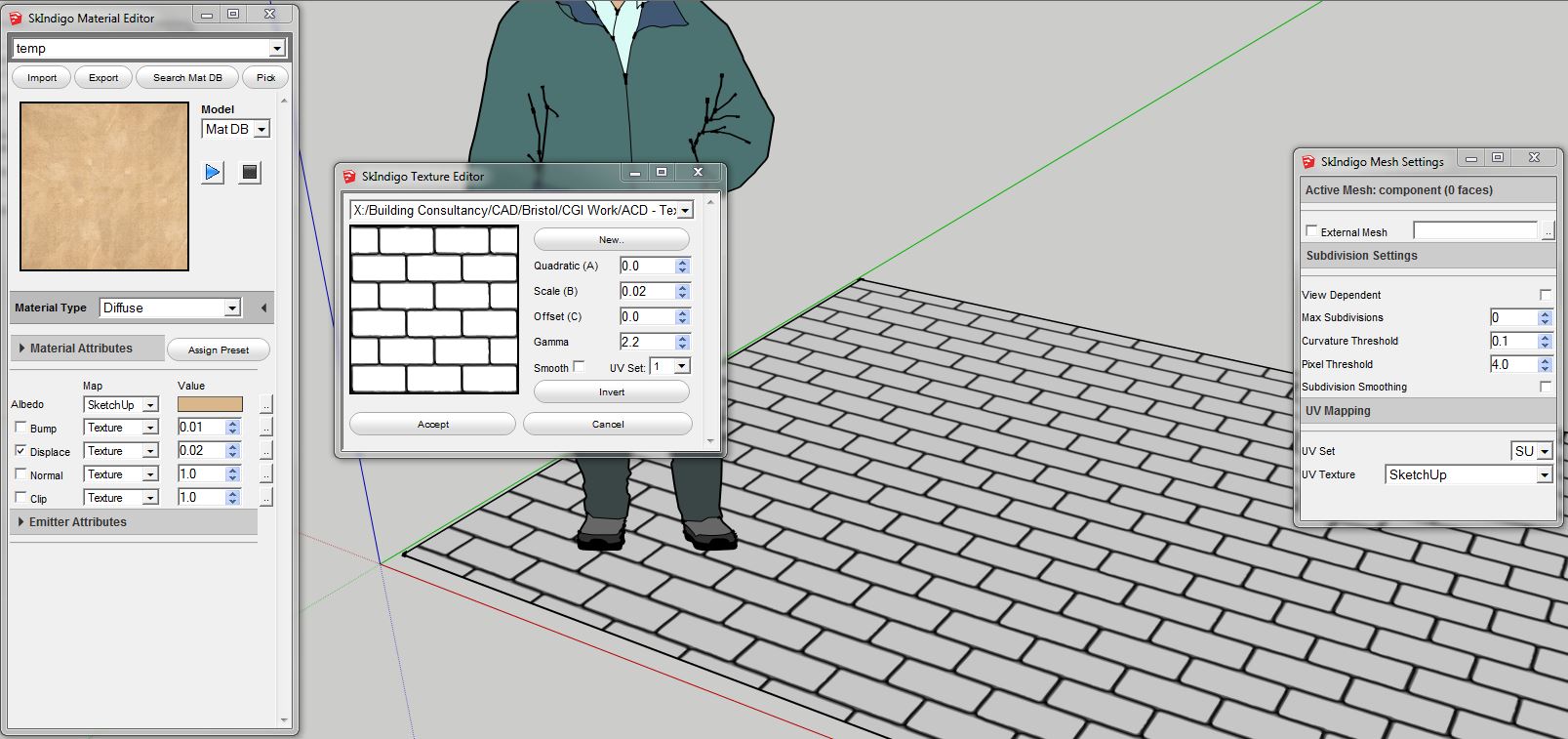

The plane is only moving, because you are displacing a single polygon. You need subdivisions in order to make displacement work.

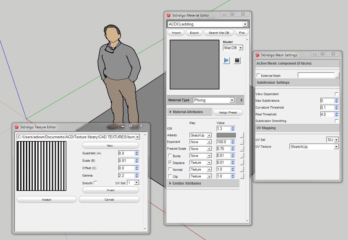

Thats what I figured with the displacement, but I'm setting subdivisions in the mesh edit to 9 (as per the tutorial) so I assume its not that.
It used to work great, but now doesn't and I can't figure where I'm going wrong.

OK, I had just seen "0" in max subdivisions in your screenshotBosseye wrote:Thats what I figured with the displacement, but I'm setting subdivisions in the mesh edit to 9 (as per the tutorial) so I assume its not that.

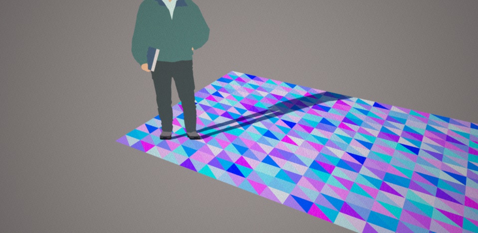

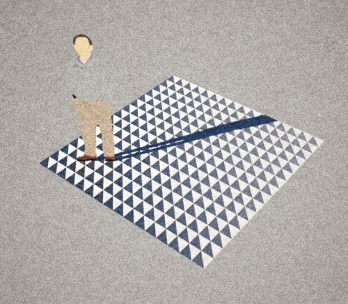

Set material to diffuse but keep displacement
Render scene in Indigo
now select that material and check the ckeckbox "random triangle color"
Now you see the polygons that subdiv created, by selecting the mesh in the GUI you also can tweak and doubleckeck the subdiv settings on the fly, good for debugging...
if you could upload the igs scene, that could help checking for the issue

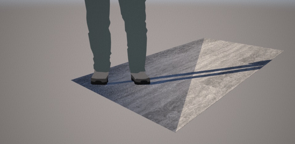

Thanks for the reply. OK then:

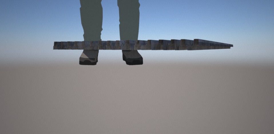

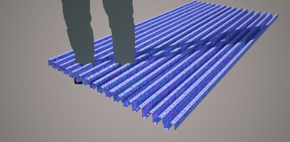

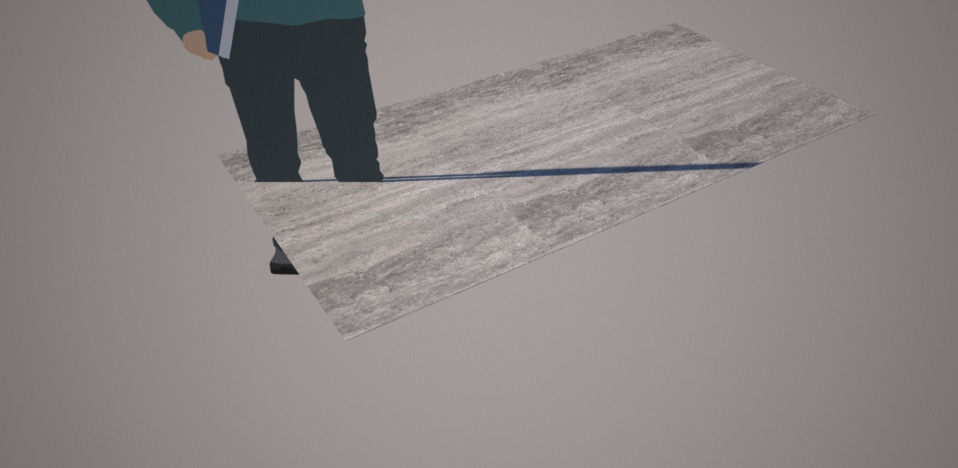

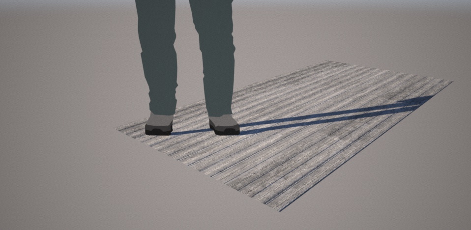

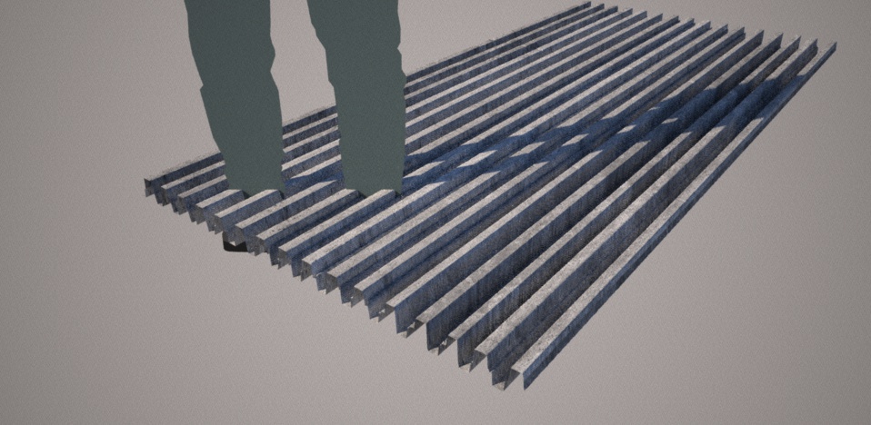

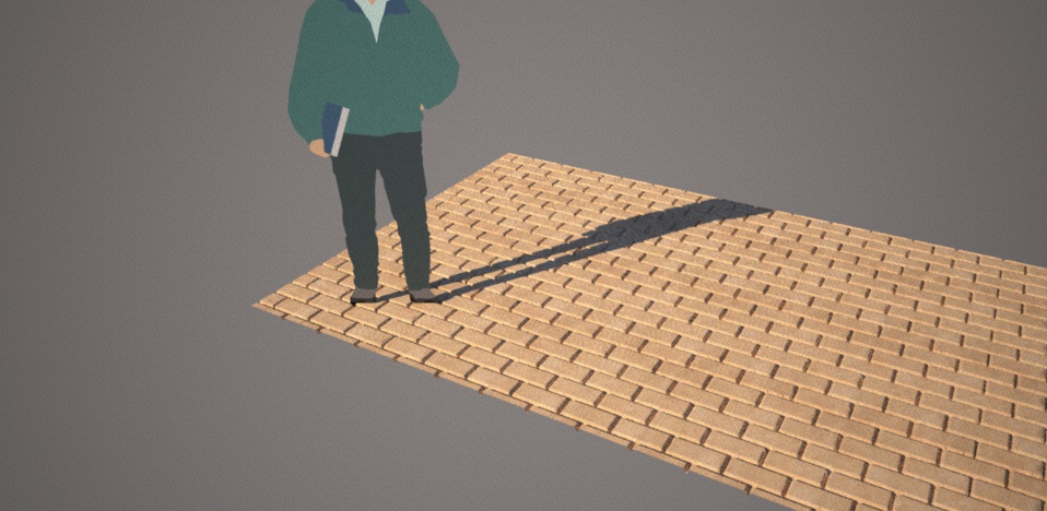

Displacement added with subdivision 9, UV set 1. Entire plane is just shifted up. Triangle view also attached. Displacement added with subdivision 9, using Sketchup for the UV set. Displacement appears to be working, but the entire plane is still shifting up (Steve is no longer stood on the lowest portion of the plane, its halfway up his legs again), albeit with some displacement evident. So this is not correct either surely? Also using SU as a UV set means I have no control over the way the displacement is applied
Ok, so lets try a bump map using UV set 1. Curious artifact. Bump map with Sketchup as the UV. Works, but again I have no control.

A good chance that this is very correct mate!Bosseye wrote:but the entire plane is still shifting up, albeit with some displacement evident. So this is not correct either surely?
displacement does a full shift with a pure white pixel of the b setting, and a zero shift for pure black!
Does your texture have any pure black? usually not, since most displacement maps are centered around 128 RGB grey!
To use such a texture you need to adapt the displacement setting:
if you shift by lets sac 10cm (b=0.01) then you need to set c to -0.005 (half of b negative)

Re: What am I doing wrong here? (UV displacement)
another issue I found in your setup:
gamma needs to be 1.0 for displacement, same as for fresnel map, bump, exponent, blend...

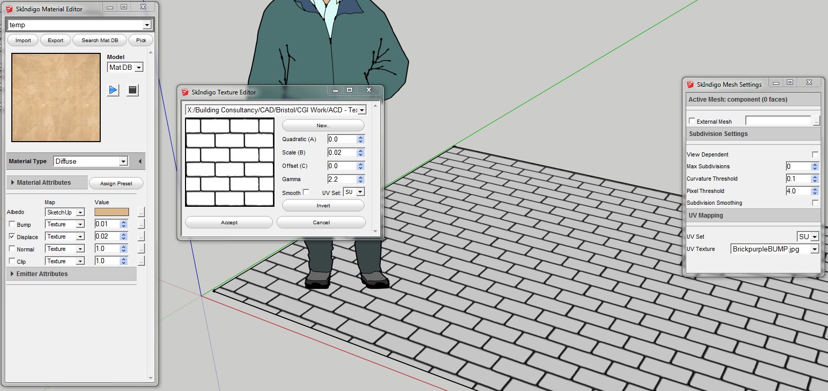

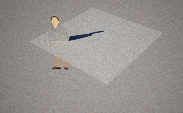

Ok more testing:
Everything seems to work as required as long as I use Sketchup as the UV set.
Using Sketchup as the UV set: Displacement seems to work ok, and is using the UV set I have applied in the active mesh.
The issues seem to stem from trying to use a different UV set, in this case set 1:
As you can see, no displacement is evident at all.
It must be user error, but what I don't know. Guess I'll just have to use the SU UV set!
