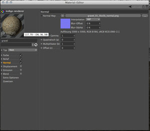

Post by zeitmeister » Wed Jun 05, 2013 9:51 am
Hi,
I wondered how to decrease the normal map strength.
Increasing or lowering the "multiplicator"-value (b) results in very strange effects.
Does someone know something...? :(
Thank you in advance!

zeitmeister wrote:Hi,
There is a simple solution : neutral normal map is (128,128,255) color.
So you could try to blend your NM with that color. I'm don't think you can do with Indigo, though, you need an image editor.

Post by Zom-B » Fri Jun 14, 2013 4:37 am
zeitmeister wrote:I wondered how to decrease the normal map strength.
I also noticed that the Gamma of the normal map is 1... strange for a RGB color map.
In the material window the preview also show a bleached out preview. But setting the gamma to 2.2 does let the texture preview look fine but your Rendered material the world turns upside down -.-'
